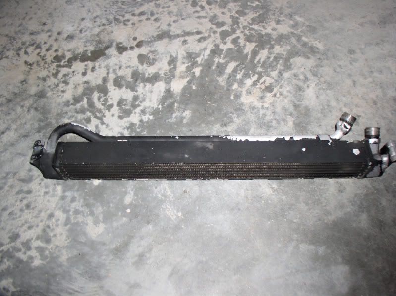

hey Tradin1, is that an OE E46 M3 cooler and bracket that you have modified to fit or something else entirely with a custom bracket that you fab'd up?
Cool. Any idea if the oil filter housing 11421405197 would be any better alternative to the 540i gulf version?
Could also use the cooler from the 750iL or E46 M3 and they have the inlet/outlet both on the driver's side. (for LHD)
just some food for thought for you guys.
That is a nice viable alternative. Interesting how the incoming air goes straight through, vs. what "You know who" from Morgan Hill came up with, in regards to mounting angles.
