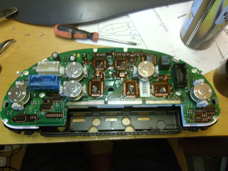

I removed and stripped the cluster down. I had to drill four 5mm sized holes to gain access to the four Torx (Tx 9) screws that hold the white plastic LCD carrier to the circuit board (and also clamp the ribbon, applying pressure to it).
This was quite a daunting task but it turns out that it's not so difficult (careful measuring/marking and bending back the dial backing - grey on mine). Also, from what I can see, there are no ill effects to the lighting on the cluster after doing so.
Drilling means that the dial needles do not need to be removed; from what I understand this is no bad thing as when the needles are pulled up, they tend to pull the spindle up from the motor and ruin the return spring in the process, another problem and cost - this is avoidable.
In the end I had the dials and the bare lcd hanging underneath. I took this back into the car to check where the connection was bad (circuit board or LCD). I found that the problem was at the circuit board end of the ribbon, but the pixel loss had got much worse.

#3 ·
I didn't take that many pictures I'm afraid.
However, have a look at THIS LINK, it has several high quality pictures and it contains the locations of the holes (pics 10 to 13).
Incidentally, the guy in the above link states that the screws are Tx10, but on mine they certainly were Tx9. Also, he states that it's easier not to remove the screws. I found it much easier to re-fit the LCD carrier after removing the screws but make sure they don't get lost inside the cluster when you re-fit them - my Tx9 driver seemed to grip the screws well.
Screw heads are 4.4mm diameter, so a 5mm drill should give you a nice clearance to remove them with the driver.
When re-fitting the white LCD carrier, one leg (a pin that fits through the circuit board, powers the small bulbs) had to be bent a little bit. There's a motor for the oil temp gauge that's a bit in the way, a gentle bend to the pin helps to get everything back nicely (I'm not talking about a big bend here, only a few degrees that won't harm anything). You can just about make out the pins in the 14th and 15th pictures in the link.
HTH.

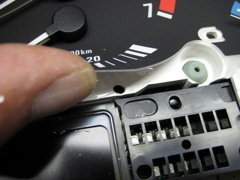

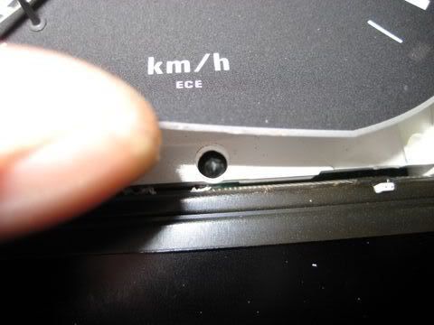

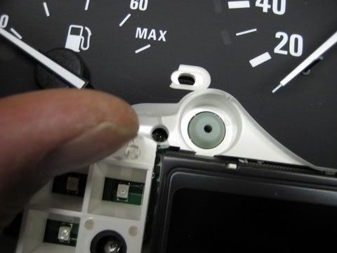

Yeah, show us where and how you drilled the holes?
#5 · (Edited)
1st hole:
2nd hole:
3rd hole:
4th hole:
Edit: These four pictures have been taken from the thread I've linked to in the above post. They are 'Edwin's' pictures (from bimmerboard.com) and I've linked them to his photobucket account. I just wanted everyone to know and for Edwin to receive his due acknowledgement. Thank you Edwin for such wonderful pictures.
I welcome anyone to use any of my photobucket pictures, as long as I'm acknowledged in a similar fashion.
As I've previously mentioned, I did not take many pictures. If I go back to this one day, maybe I'll take some shots myself. However, Edwin's pictures are very high quality are in focus and they do show what was required.
I lifted the instrument backing.
I carefully measured out and marked the locations for the holes.
I then drilled a small pilot hole (2.5mm iirc) to double check the locations.
I then used a 5mm drill bit to drill out the holes so the screws could come out.
I used a cordless drill with variable speed (ie not on/off) so I had better control over the drilling.
The instrument backing covers the holes so there's no chance of them being visible once everything is back in it's place.
HTH.
