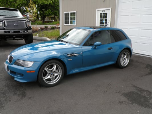

Someone said it before and I SERIOUSLY suggest you go take a look at one. Check out the Z3M coupe.
This car is truly RAW. It has amazing power, and amazing handling. And, although some don't like the looks, I think it is one of the sexiest BMWs ever built.
I just picked up a Z3 Coupe 2.8L, with a Mcoupe tranny, shifter, and diff. This car is very fast, handles amazingly, and leaves you feeling really connected. So, I can only imagine how the Mcoupe actually feels with the S54 motor. I just drove my m5 after 2 weeks of just driving the Z, and i sat in the m5 and it is just a completely different feeling. The Z cockpit is snug, whereas the M5 is big and spacious.
Don't get me wrong, I love everything about the M5, but the Z coupe is just a raw car. Plus, it has an excellent ride.
