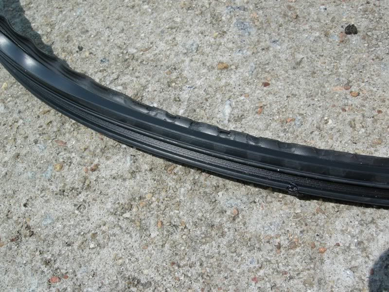

Symptoms - Cracked and chipped windshield rubber seal. For a June 2007 build, the rubber has held up pretty good up until the last few months. It has started to fall apart with the slightest touch (washing the car, etc). From what I've read this is not a weather / rain seal, just a trim part.

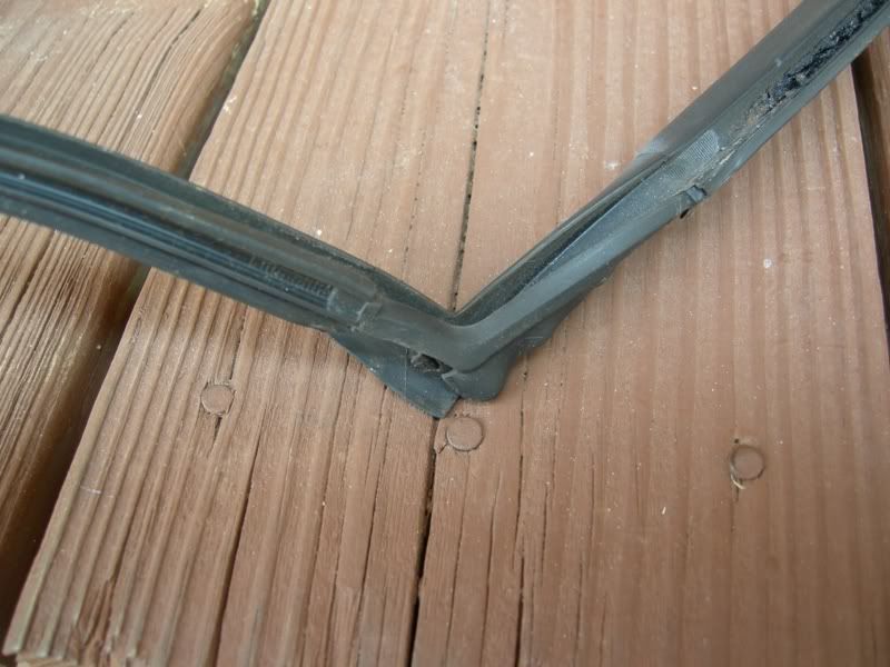

Only $31.26 including tax and he had it in stock. I picked it up yesterday and nervously started last night. First step is removing the old rubber. I used a plastic butter-knife type tool and a Stanley pick tool with a hook on the end. Just pried the passenger side top corner up with the plastic tool and got the hook down in the rubber and worked it up. Suprising how deep the rubber goes down in there. Once you get it started, pulling the whole molding out is a snap, it just pulls out all the way around the windshield. It did leave behind a black, gummy residue in the channel that cleaned up with some WD-40 and several Scott's heavy duty throw away rags.

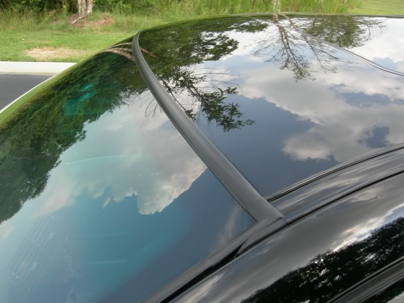

Once the area was all cleaned up it was time to get the new rubber in. I did think I was a little in over my head because the molding looks like it doesn't want to fit in the opening. But I just got it lined up and it pressed in place with thumb pressure. I was really suprised but it snapped into place without much hassle at all. I did the top all the way across then the sides. Pressed it all in place, ran some Gummi-Pflege on it and let it sit overnight.
Cleaned everything off this morning, made sure everything was still in place and it was. Overall the job took about a half hour.
When the rubber started craking I thought I was in for a huge bill or life with a cracked windshield rubber gasket. But this is definately a DIY job. It really improves the appearance of the car and gives it a little "newness".

Instructions above are great, so I did mine today and have posted before, after, and during pictures to help the next folks. Having broken a windshield as a teenager many years ago doing a similar replacement on a different car, definitely use a plastic putty knife. It is dead simple. Plastic putty knife, Goo Gone and/or isopropyl alcohol, and some rags. I also found doing it in the sun helped since the new trim piece was softened and very easy to seat.
As noted in other posts, start at the bottom and just peel up and away. Clean the channel well with Goo Gone (I put it on a rag that I ran through on the edge of the putty knife). I then also used compressed air to blow away anything else and finished it off with isopropyl alcohol before the new trim. As the other posts, ensure the top corners are lined up, then seat the top, then the sides. Note the new trim has adhesive, so try to only do it once. Cleaned up any adhesive that rubbed off the new piece with the alcohol and that was it.
Attached see the removal, the clean channel, starting installation (in a corner), and finished version. Also before and after pictures of the driver side and the top. Hopefully these help someone else and you too can spend $40 and some time instead of a windshield replacement.

mjohnson - glad I could help. Your molding was WAY worse than mine, it reminded me of my 1999 528i's molding, chipping away by the day. My molding was in the beginning stages of starting to go.
Very suprising how easy this was to do. For some reason it seems intimidating, but one you get started, its really noting at all. I know M5's are garaged and better maintained that your everyday 5 series car so maybe the problem is not so rampant among M5 owners, but since we're dealing with cars that are turing 7 years old this year, garaged or not it's time to change those windshield moldings :D
