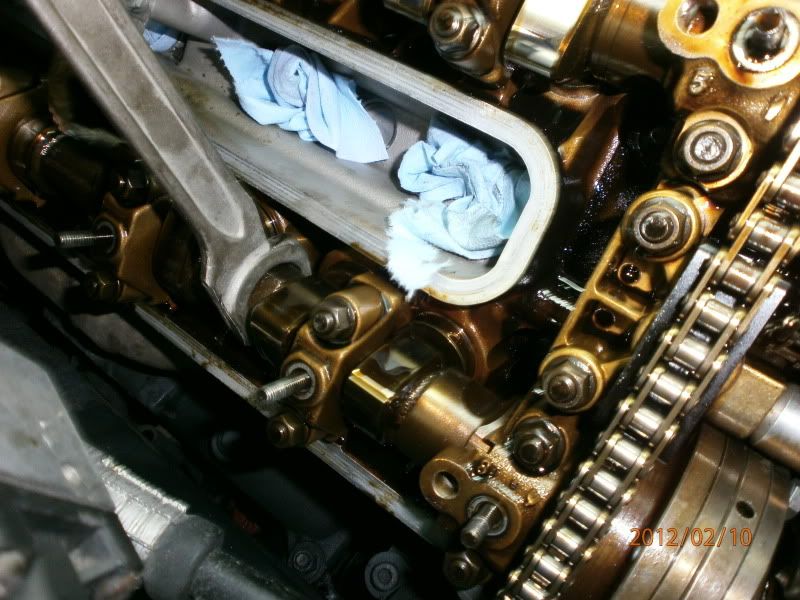

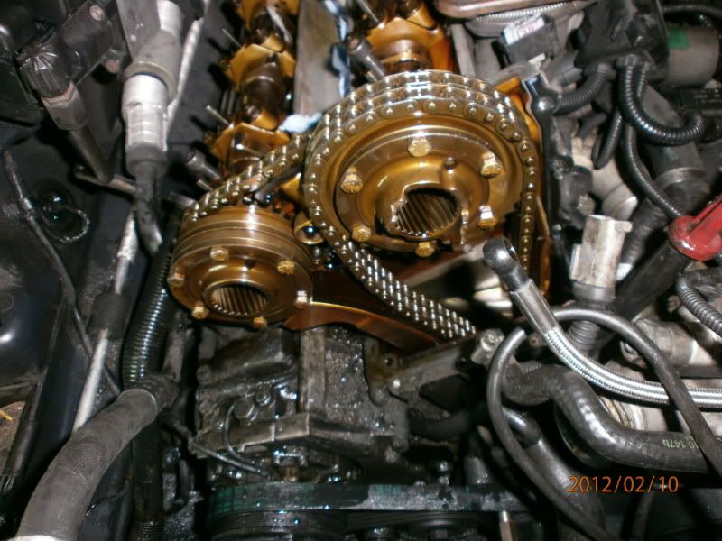

Now, your engine should look something like this, except your helical gears are attached to the vanos unit. Don't worry.
OK, the bolts you need to make sure are loose are the 6 bolts around each of the outer helical gears you can see on the above picture. Here is a better view of the bolts just to show you
you need to do this in a particular order, so follow.
You need to turn the engine over clockwise until the engine is in number 1 cylinder firing position first.
You will know this because when you insert the crank lock pin
and your cam locking pins or bolts too, then your timing mark should line up in the groove on the first bearing cap.
When you insert your crank pin, you may not be able to insert your cam lock pins straight away, because your vanos is out of the car. Don't worry, you should use your 27mm spanner on the cam to turn the cam to the position where you can insert your cam pins and the timing mark lines up in the groove. For an idea of when you are on the firing stroke and not the overlap stroke if you cannot see the timing mark straight away, is when both valves are closed, and the cam lobes are pointing directly away from the valves, you can see this in the picture.

Now remember the 6 bolts we talked about on each of the helical gears? You should be able to see 3 bolts on each of the cams. You want to loosen these off maybe 3 turns each
OK. now take your pins out again, and turn the engine over 1 complete revolution back to cylinder 1 firing position.
Insert all of your pins again, now the timing mark should be lined up in the groove on the first bearing cap again. We do it this way so we end up with all of our bolts loose, and ready to put the vanos in with the engine in its firing position as we can see all of the marks when we install everything.
OK, now you should be able to see the remaining 3 bolts on each of the helical gears. Loosen these off 3 turns.
Now you should be able to move the helical gears with your fingers left and right.
