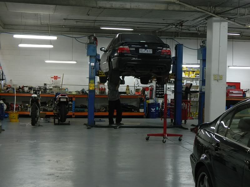

I took the car back to the workshop and the mechanic hoisted it back up and was certain it was my rear sway bar bracket. But i don't see how a rear sway bar knock would almost cure itself after the car has warmed? Or would it?

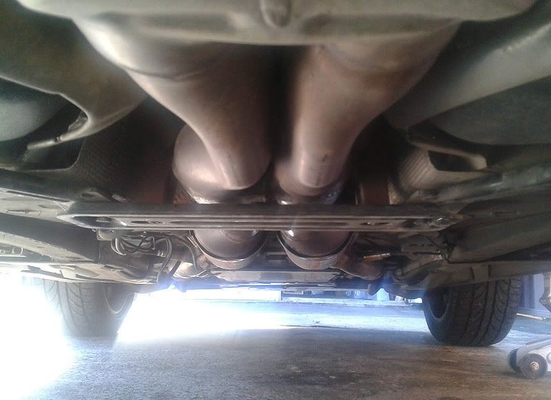

Okay so i've jacked the car up and gone underneath. Please see my video underneath :1zhelp:
Does this sound normal? Or should it not be "knocking"?
Should i place some material between the exhaust and the brace? I was thinking of shoving an old rag in between there for now?

That's it! I would just make sure everything is tightened up. Might just be loose?

Problem solved! I used some heat resistant wrap, bunched it into a neat pile and placed it between the exhaust piping and the flat "connecting support" part No. 5. Tightened it up good and it hasn't made the knocking sound since :grinyes:

I'll jack it up and reverse it so that it's Washers > Braces > Bracket like 68's setup (below). The sandwich fix has made it bit too loud for me now :confused3

The mounts have probably perished somewhat and I'd say it's knocking now because everything was taken apart and put back together and tightened properly and has pushed the exhaust closer to the cross brace and caused the knocking.

I did the reverse set up with the bracket like 68's. Perfect. No more banging noise and no more exhaust drone!
