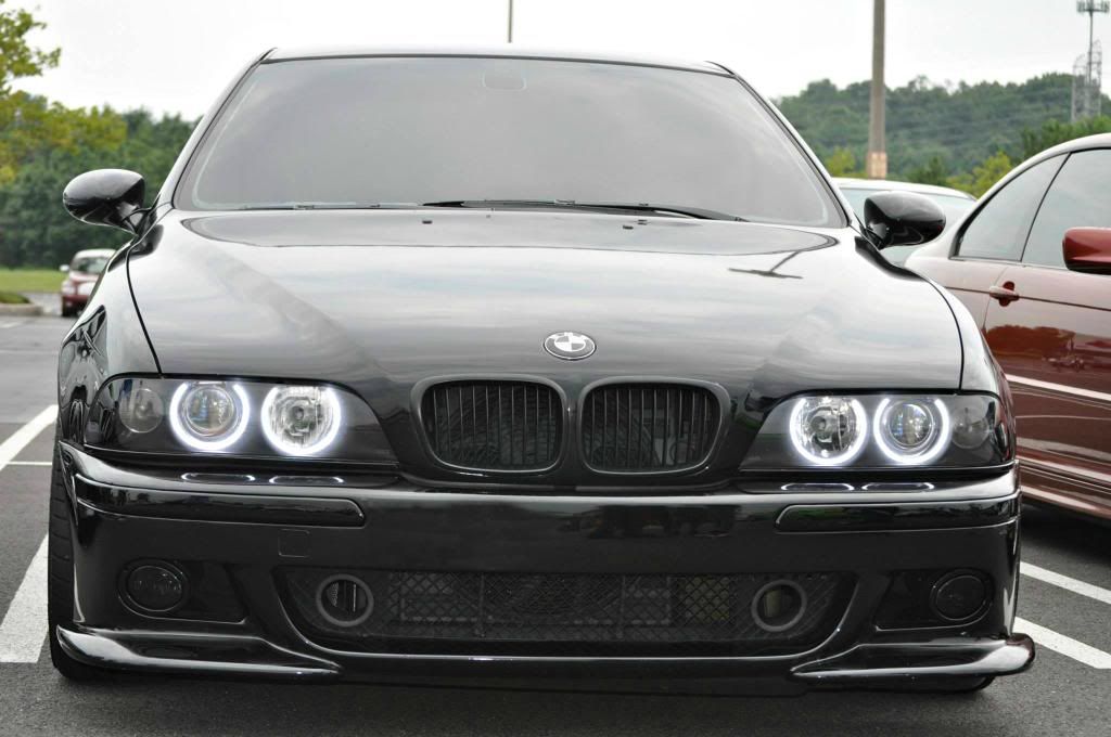

How my M5 sits right now. It's pretty low. I got my fenders rolled and my plastic cut so I don't rub. 15mm up front to clear the ST's. on a square setup. Ill update this thread on how my M5 turns out. Any questions, hit me up! thanks for looking
