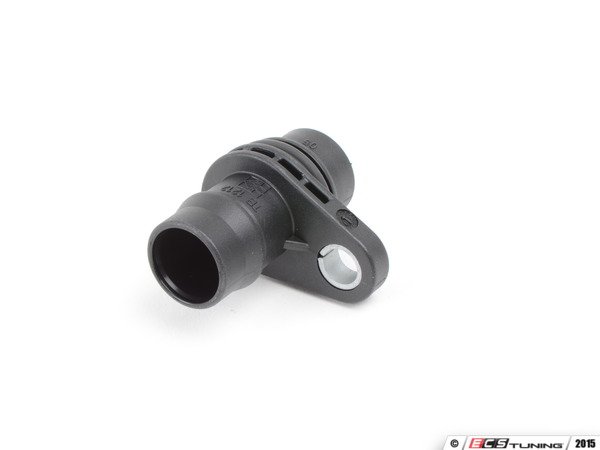

You take the hose off at the intake manifold and check if it has oil at the top. Don't change the PCV valves needlessly.
They are like $20. Got them from ECSTuning.
One important thing I have realized, always buy genuine BMW parts. They have the perfect fit.
I got 4 of these, and have 2 left still.
