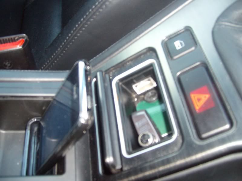

Initially I was going to fit this into the ashtray, but it was going to take a lot of work, proably look rubbish, and I was worried that it wouldn't be stable enough and I would keep knocking it! AND what then really stopped me is that there was no way the cable would have fitted into the bottom of the ashtray and if I did manage it there was no way the ashtray would be able to close.

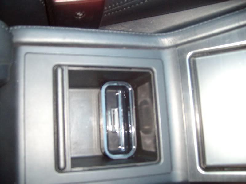

So I then looked elsewhere and came up with this, the iPhone rests on the bottom giving it some extra support.
It cost me ÂŁ20 to do the entire job, as all I did was used the slack on the cable to the Alpine-KCA to move that to the ski hatch (which I dont have, but have a hole which said wire went through) then under rear seats, carpet and with some skin missing from nuckles into the centre console, bodged a hole in the back of the drawer and double sided sticky tape on the Scosche adaptor and Bob's your uncle!

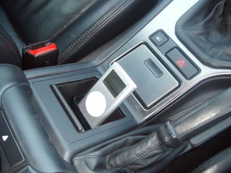

It fits a treat, you can see the screen and access it fairly easy, of which is difficult if fitted into centre armrest, ashtray, or cupholders.
All in all I am very pleased, also you can plug iPod in if needed. Or should I say should wife be driving without iPhone!
Also, you can still use the ashtray:
