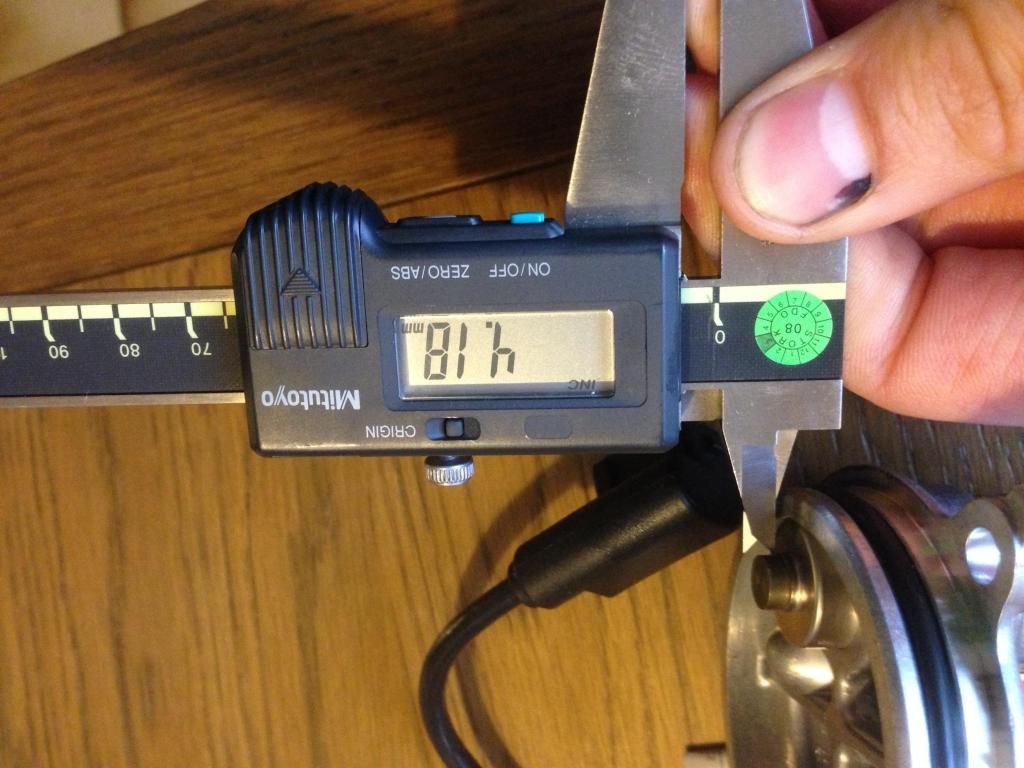

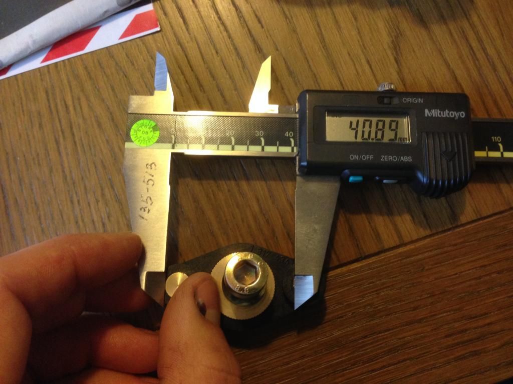

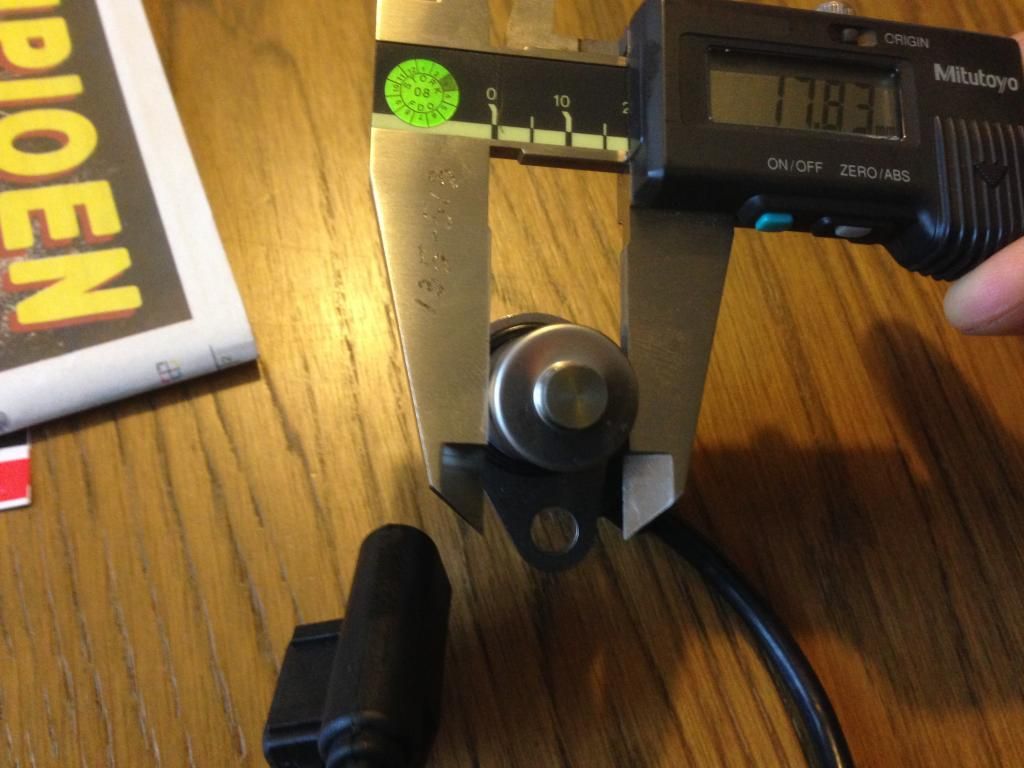

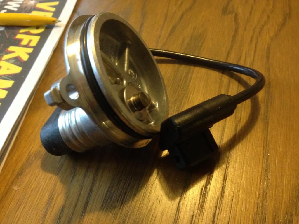

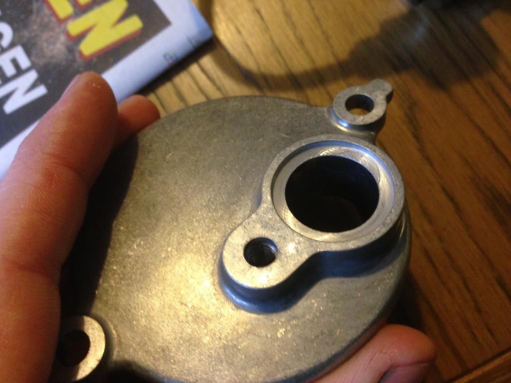

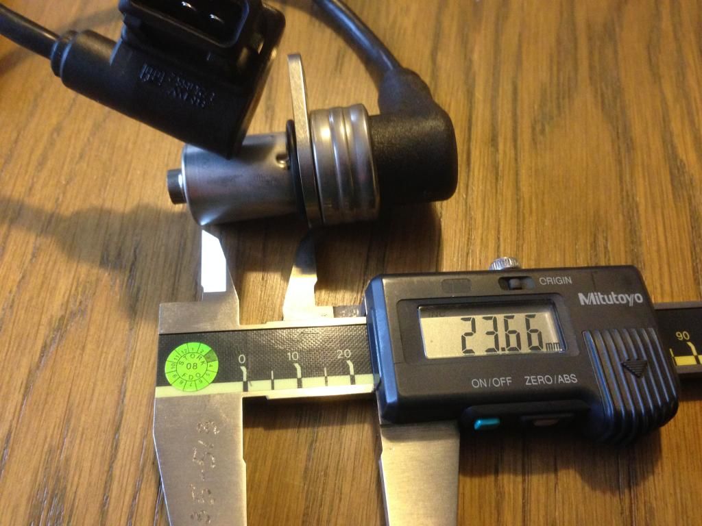

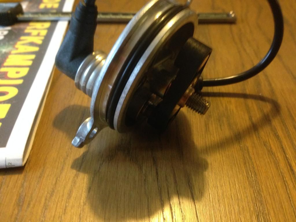

Here are some pictures/dimensions of the B38 cams sensors. If you need any more please let me know as I haven't mounted it yet. Hope it helps.
