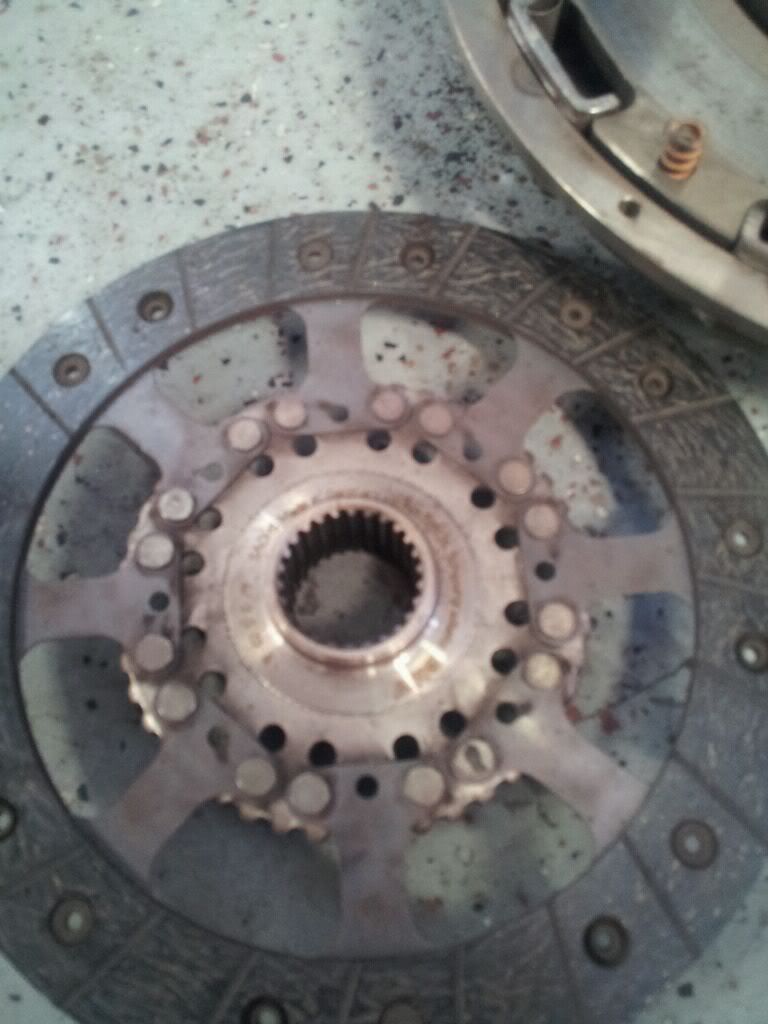

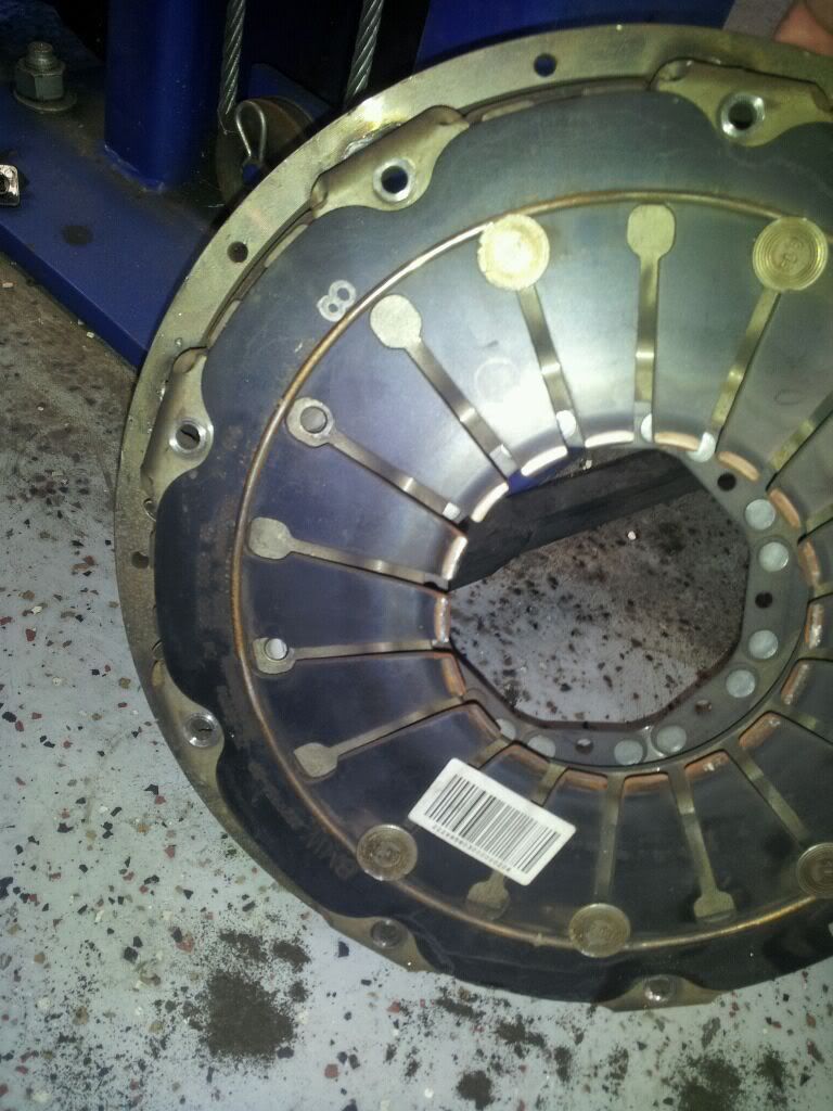

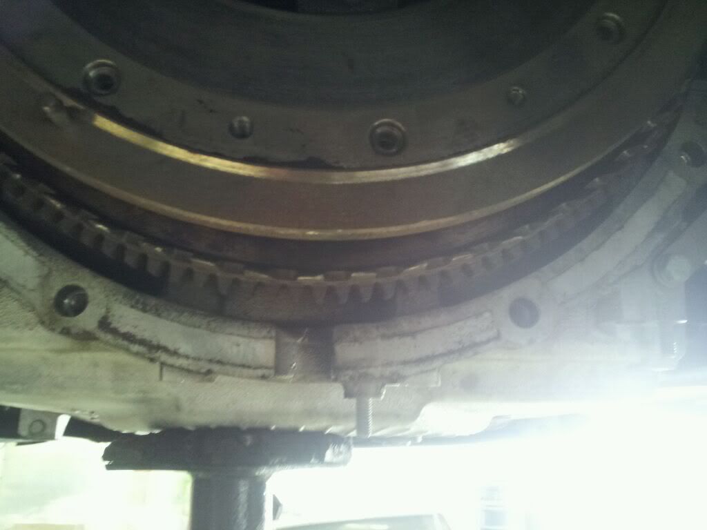

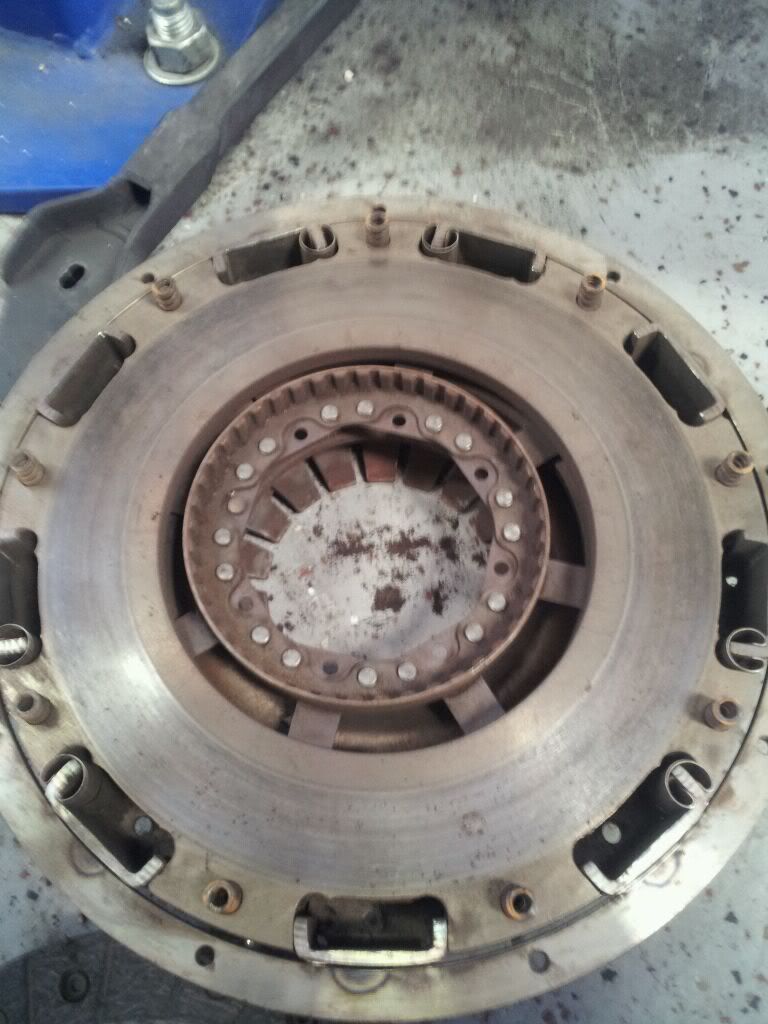

so i had the tranny pulled out and my buddy found a few screws dancing around in the bell housing and noticed that they were from the pressure plate.
the dual mass flywheel had a lot of play and some of the teeth were damage from the screws dancing around. believe it or not the clutch disk was in decent shape and has quiet a bit of life to it.. i'm replace the entire clutch assembly with a after market one.
thanks for the help guys ill try and get some pics..
