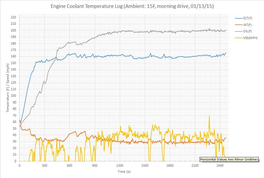

I was throwing a P0128 error, which is a low coolant temp error. When I took the car on the highway on cold days, the error would light up because of the increased radiator airflow, and because the thermostat was open when it should not have been. (Mine was not stuck upen, but was opening at about 60C according to KTMP.)
