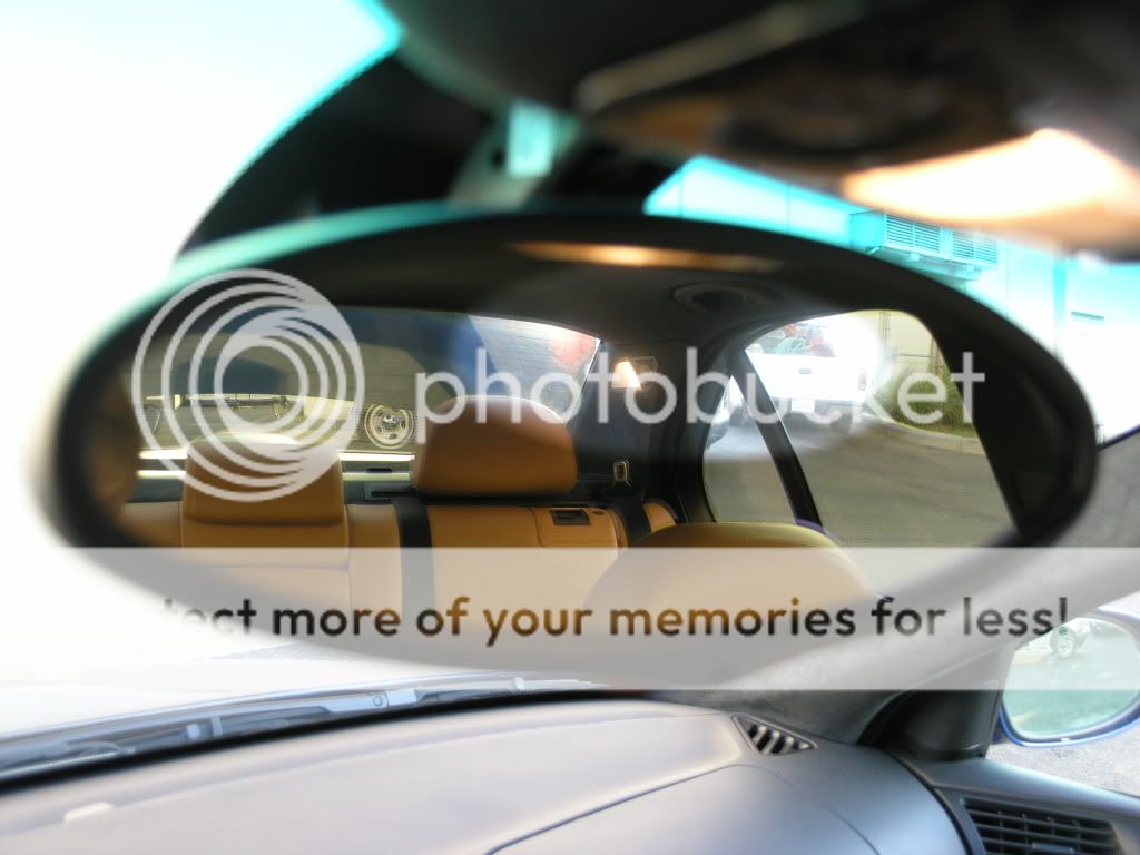

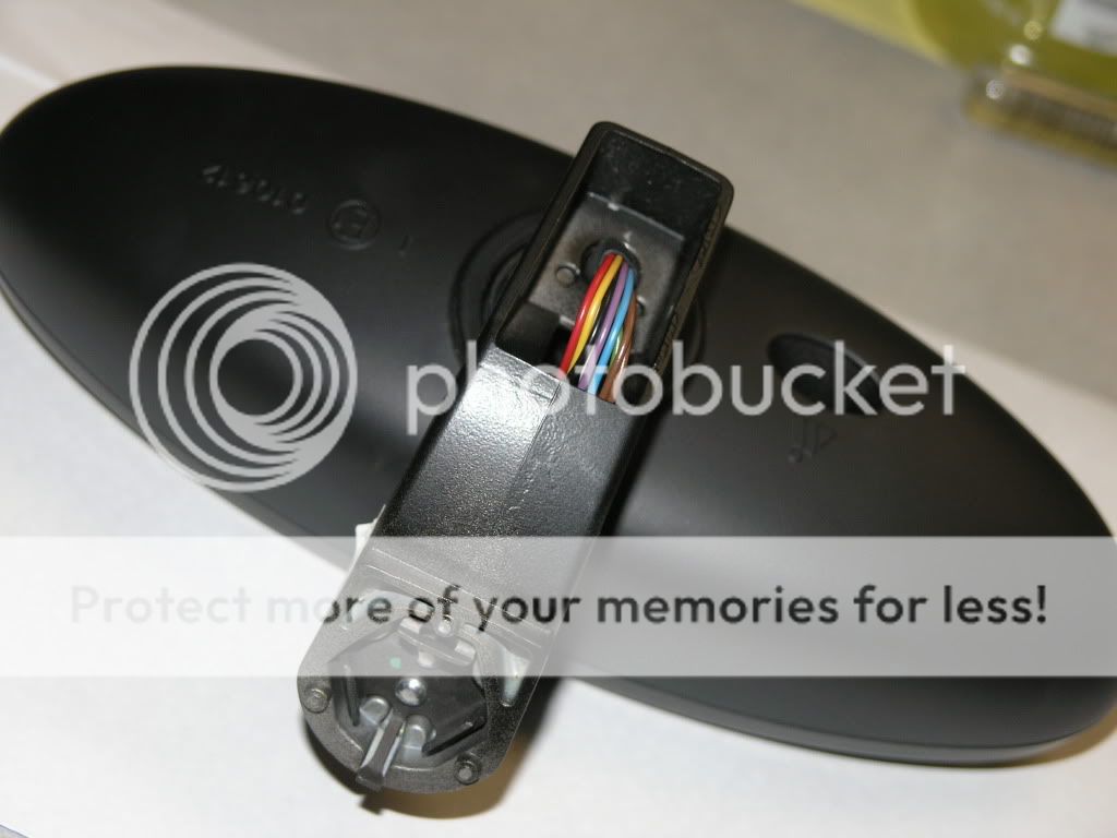

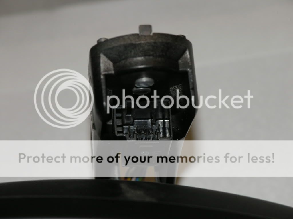

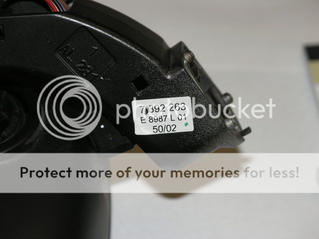

I did mine recently.
Contacted Stacy at Sybesmas
They will email you a form to complete, and specific instructions. Note, they do not exchange mirrors with HomeLink built into the mirror(This means having buttons on the mirror). If the garage door opening buttons are on the center lighting console, you are good to go. You will need to take pictures of the mirror including the wiring harness to include with your form.
Failed mirror
Back of mirror
Wiring Connector
Connector on mirror
Important sticker with model numbers on side of mirror stalk.
Wire colors on mirror(there are 9 wires)
IMPORTANT REMOVAL/REPLACEMENT INSTRUCTIONS
