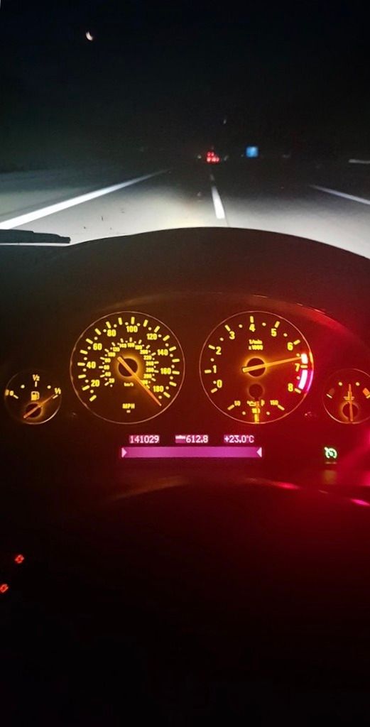

I hit 320 kph in evolve supercharged stage 2,,,stock diff.6th gear
Not gps ,,it is speed dials.
I scared,,I did it only once.
I do not know if it will go faster.
The car fly,,very scary.
Thank you.
