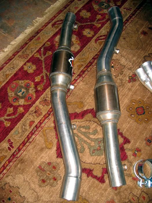

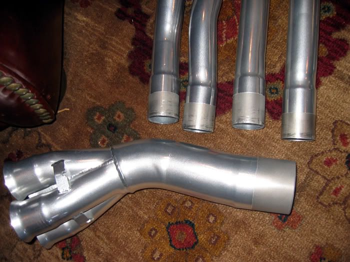

After hearing of possible fitment issues of the header primaries into the collectors after ceramic coating, I had the ends of the collectors masked to avoid this problem. It's still a very tight fit so I would imagine with the thickness of the coating, the primaries may not have fit into the collectors. A local company did the work so I'm not sure if Jet Hot would do this or not but it's something to consider for those of you considering ceramic coating your SS headers prior to install. And UPS delivered my SS race cats today as well.:applause:

This is classic! Exhaust/header parts all laid out on your oriental rug !!! :cheers:
