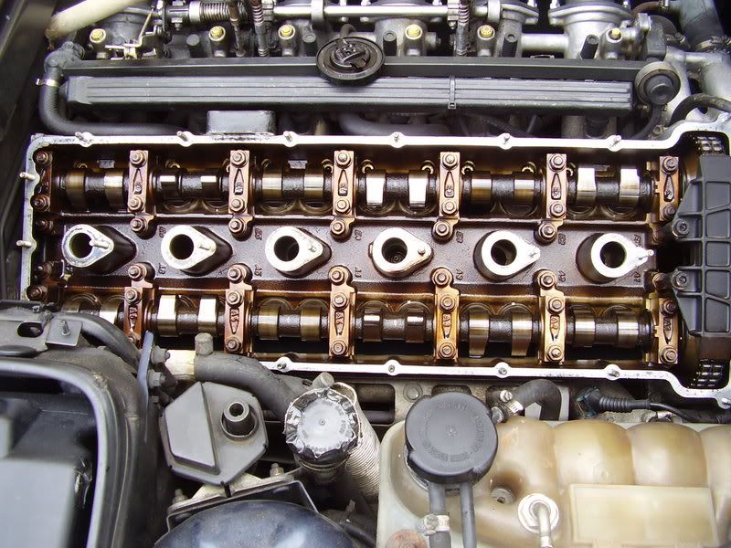

Gidday all, could someone put me straight on this, as I need to replace plug socket gaskets as #6 is weeping a bit in plug whole, are they accessable from inside top cover, I will renew top cover gasket as well and maybe check valve clearances at same time, thanks heaps, Steve :M5launch:

Thats really good thanks, I havent been in the top cover yet, wasn't sure if I needed to remove cambox , but that looks clear enough. That # 12 inlet looks a bit discoloured is that ok as I might find similar, all the best Steve cherrsagai

No problem ...
All was well when the clearances were checked .......I suspect that the light is giving the appearance of discolouration / over oily .
