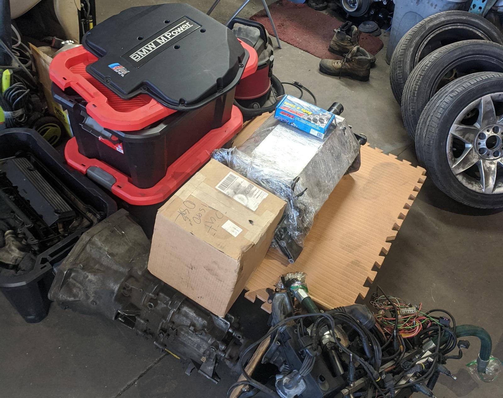

Been awhile since I've been around these parts! I owned a 2001 M5 way back in 2009, sold it but never forgot the feel of that amazing engine. Have been in the Z3/E36 world since then - the S54 Z3 M coupes are a lot of fun, but something about that S62 keeps calling my name! That BMW V8 torque is something special. Late last year I started working on an N62 swap into a Z3 and finally got it running last month. Last week, as a late birthday gift to myself I bought myself a disassembled S62 and now am embarking on the process of rebuilding it while finishing up the fab work on the N62 swap... I am not entirely sure what chassis the S62 will end up in, but most likely it will be a Z3 - possibly a roadster (the Poor Man's Z8)
The S62 I bought did come with a complete dry sump kit as well - including pump, pan, lines and reservoir. But I most likely will sell that and try to retrofit an N62 oil pan onto the S62
Has anyone here rebuilt an S62? Or have knowledge on the process? Looking over the TIS procedures it doesn't look like anything stands out as being too crazy but I have limited experience working inside engines and would love to hear any feedback from anyone who has rebuilt one
