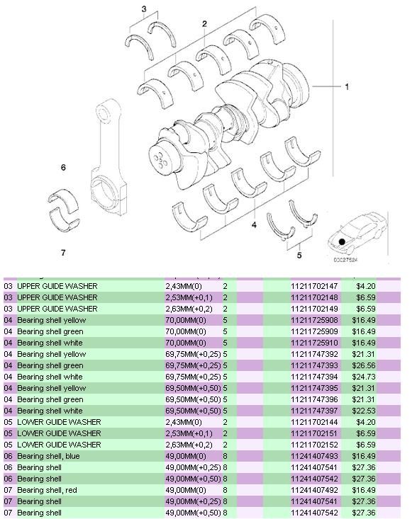

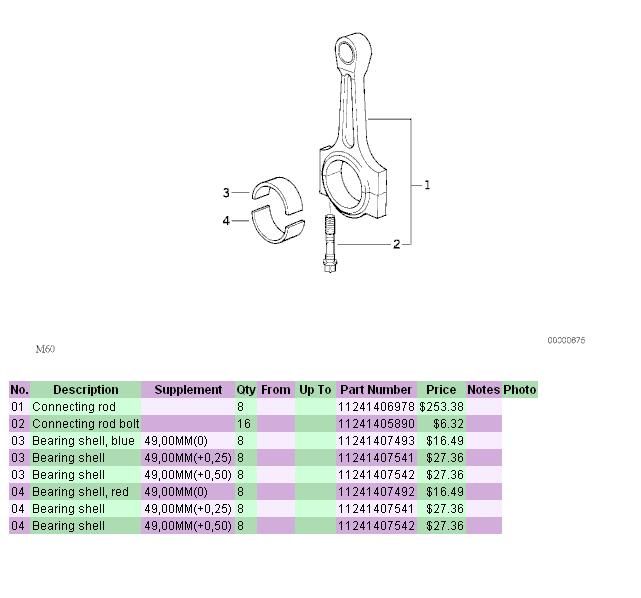

As the tittle said S62 Rod Bearings, i got a quick and simple question regarding the S62 Rod Bearings, i currently have on my2000 build date 3/2000
119k miles and i decide to tackle this job my self , my problem is the follow... which rod bearings do i need to get because when went to the dealer they ask me which i need.?.i was all of them... them they ask me which MM (millimeter)spec u need them...i ask them how many they are...i was told from 49.00mm(0 to +50) to 70.00mm (0 to +50).. which got totally confuse..i been reading other posts and treats about the rod bearing replacement and they never mention noting about this sizes ... i
This is Why written this treat to help me understand with the help of the other people who tackled this job too , which bearing do i need to get?:confused:
here is a couple pics of the sizes
#3 ·
The bearings that are not "zero" sized are for crankshafts that have been re-sized due to wear. If the crank hasn't been out of the car then it will take the standard sized bearings (well you could argue endlessly about not measuring the crank journals for wear and having them re-sized, but that is way beyond the scope of this thread).

It's Lucky that they don't use variable sizes; on some engines you have to look at marks on the block and on the crank to find the shells you need to compensate for machining differences. Some of the Nissan performance engines are like this! As someone said; if your changing shells as preventative maintenance you prob need std size shells. The oversize shells are if you have spun a shell and had to grind the crank. You def want to measure then though and also the main lateral movement; heavy clutches can ruin thrust bearings!
