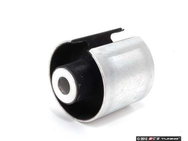

I know that the rear lower control arm bushings tend to last a long time in our cars, but I saw this bushing and wondering if anyone has tried to see if it fits into the e39m5 rear lower control arm.

My goal wasn't to save a few $, I was under the impression that the bushings aren't available separately and you have to buy the entire arm. What bushings are you guys using in the lower rear control arm on the e39m5?

Trizzuth, I am not talking about these ball joints, these don't go into the control arm but into the hub. The rear lower control arm has 2 rubber bushings, and in e39M5 there is no part number for the replacement bushings while in other BMW models there are. That is specifically why I ask the question of whether the rear lower control arm bushings that fit an X5 would also fit an e39m5. As an example, we know that in the front suspension the torque arm bushings from the X5 do fit e39m5 and some have used those instead of the e39m5 original (plenty of discussion on that). The rear lower control arm bushing that I linked in the original post is made by Lemforder (so should be OEM quality) and my guess may fit into the rear lower control arm. It is a very cheap part, but I just wanted to see if anyone has tried installing it into e39m5 rear lower control arm before.

Thanks. It is great that Lemforder decided to make the bushings separately, however, where do you see that these are specific for e39 540i? I don't see E39 chassis listed anywhere.

OP- Even if they do fit the E39 540i the rear lower "swing arm" is different on it versus the E39 M5. The 540i is a welded tubular unit vs the E39 M5 is cast alum. I didn't see a listing for it either on the link.
I went thru' this too a few years ago trying to find a similar bushing to press in to the swing arm. One of mine is torn. I searched all over. The closest thing I could find was some kind of bushing from an E30 or E36, can't remember now. I ended up just getting a used arm from Clemster and forgot about the quest to refurb the swing arm.

Damn you are indeed correct! So I guess I didn't really help with anything here, other than to realize you dilemma is absolutely REAL. I searched long and hard on E39 M5 rear lower control arm bushings and when I that link came up, it looked almost identical to the M5's control arms so I didn't even notice it was not for the E39!
I cannot believe this question has gone unanswered on this board for this long. Someone must have done this?!?! One new arm is like $850 at FCP damnnnn.

Trizzuth, now you fully understand the dilema. I did find some more info. I think that the rear bushing from the link you sent will fit the rear bushing in the e39m5 arm, so I think that problem is solved. The reason I say that is because the powerflex bushings fit all these arms (e39, e53, etc):
However, the front bushing is not cross listed, and buying an $850 arm just because you can't get one bushing seems ridiculous. As such, my guess is that a bushing from another chassis will likely fit into the front position, and I was hoping that someone has figured that out already.

I looked it up. They have the front bushing (PFR5-710-10BLK) but not the rear. The only rear they have (PFR5-711-12BLK ) says that it doesn't fit M-cars, although M5 is still listed. I think that it has a 12mm hole, and I think the M5 uses 14mm, so if you can just drill it out to 14mm it may work. However, I am not a fan of urethane bushings and would prefer original replacements if possible.
