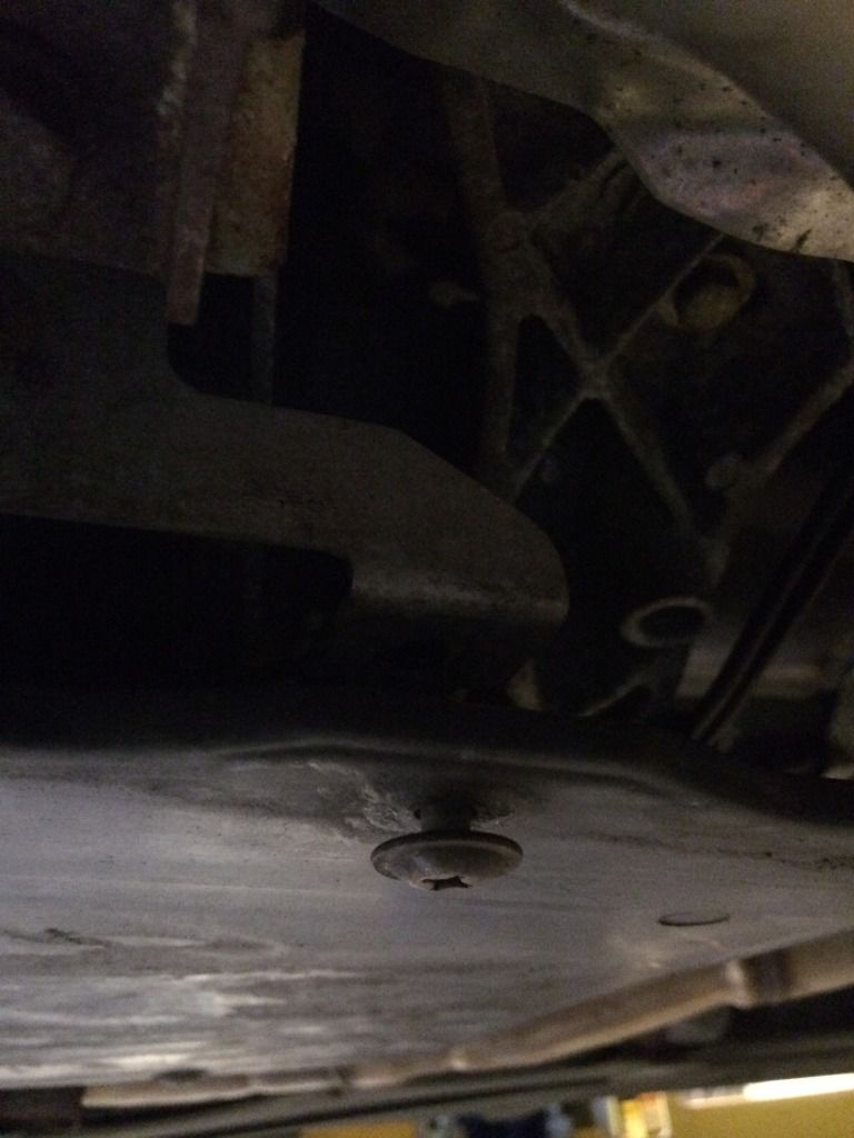

replace missing underbody panels/bolts

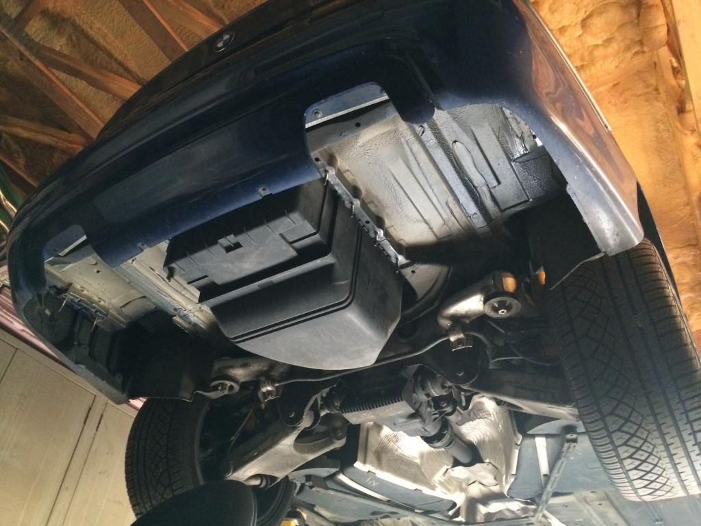

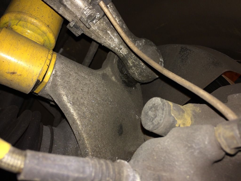

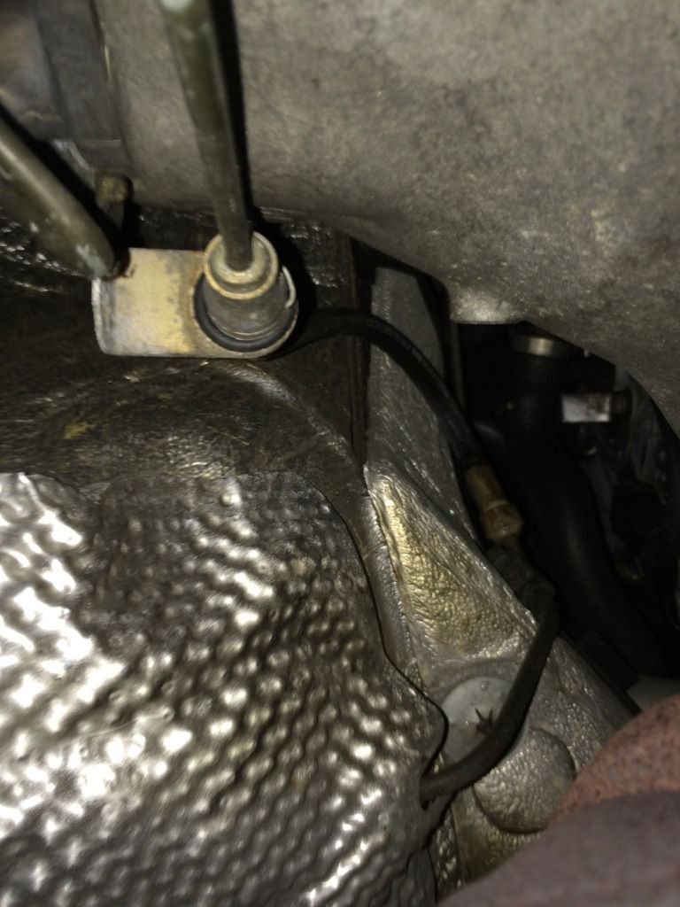

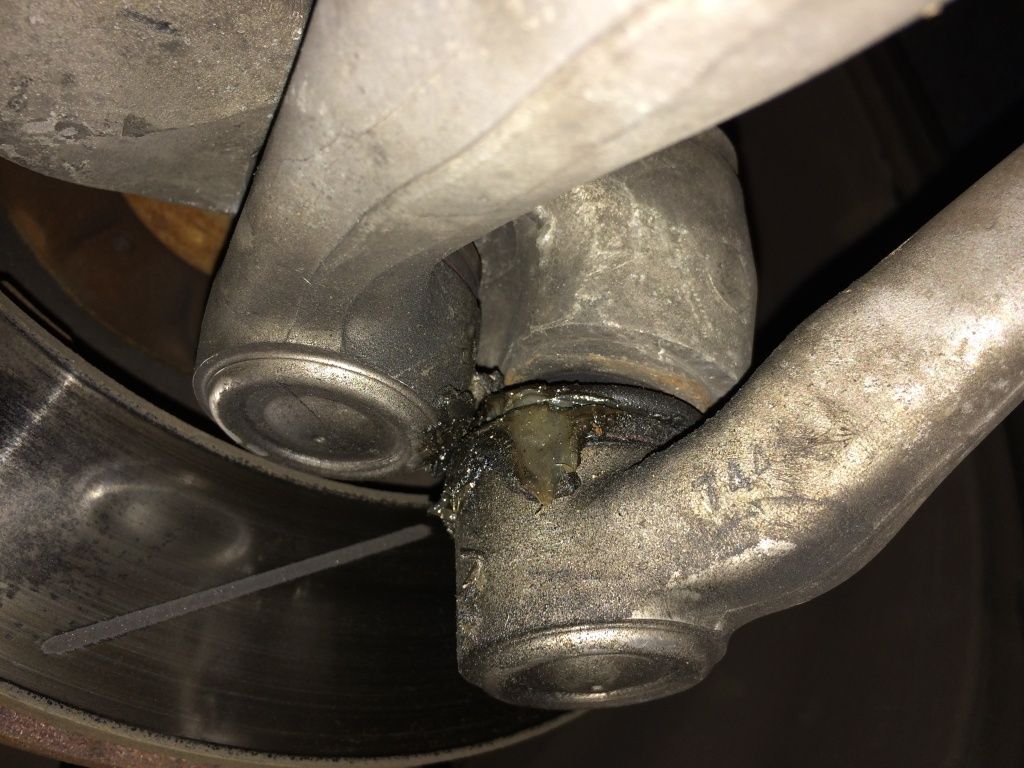

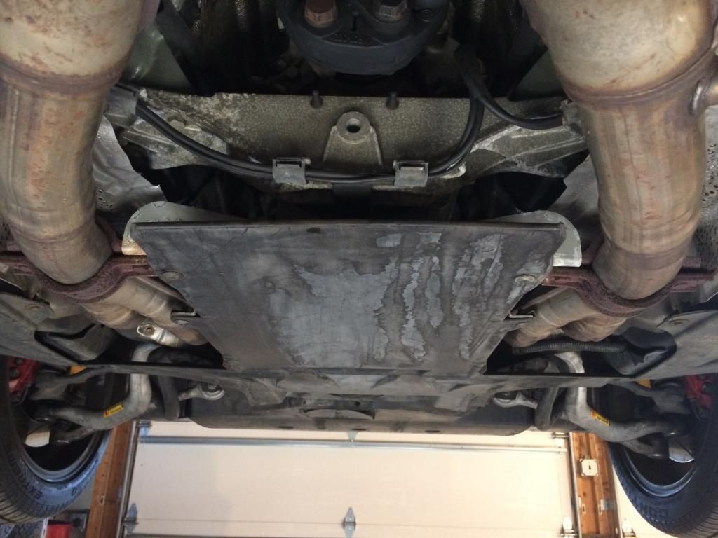

Threw her up on the lift today to see what needed address. Some good news, some bad news.
Good news: full cooling system looks to be new!
Bad news: Lots of bushings, ball joints, and seals need replacing...
clutch line is leaking:

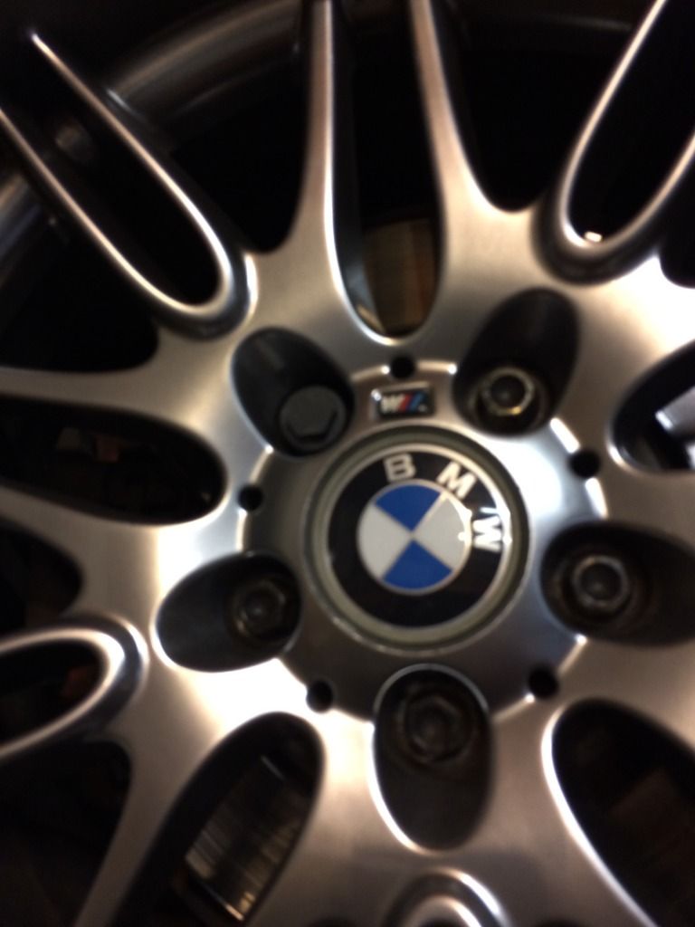

realized I need to get a wheel lock key from the PO

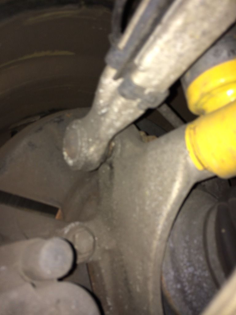

ball ball joint here
and here

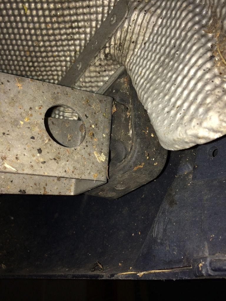

didn't get a good pic, but all 3 diff mounts need replacing
one of the 6 exhaust hangers is failed

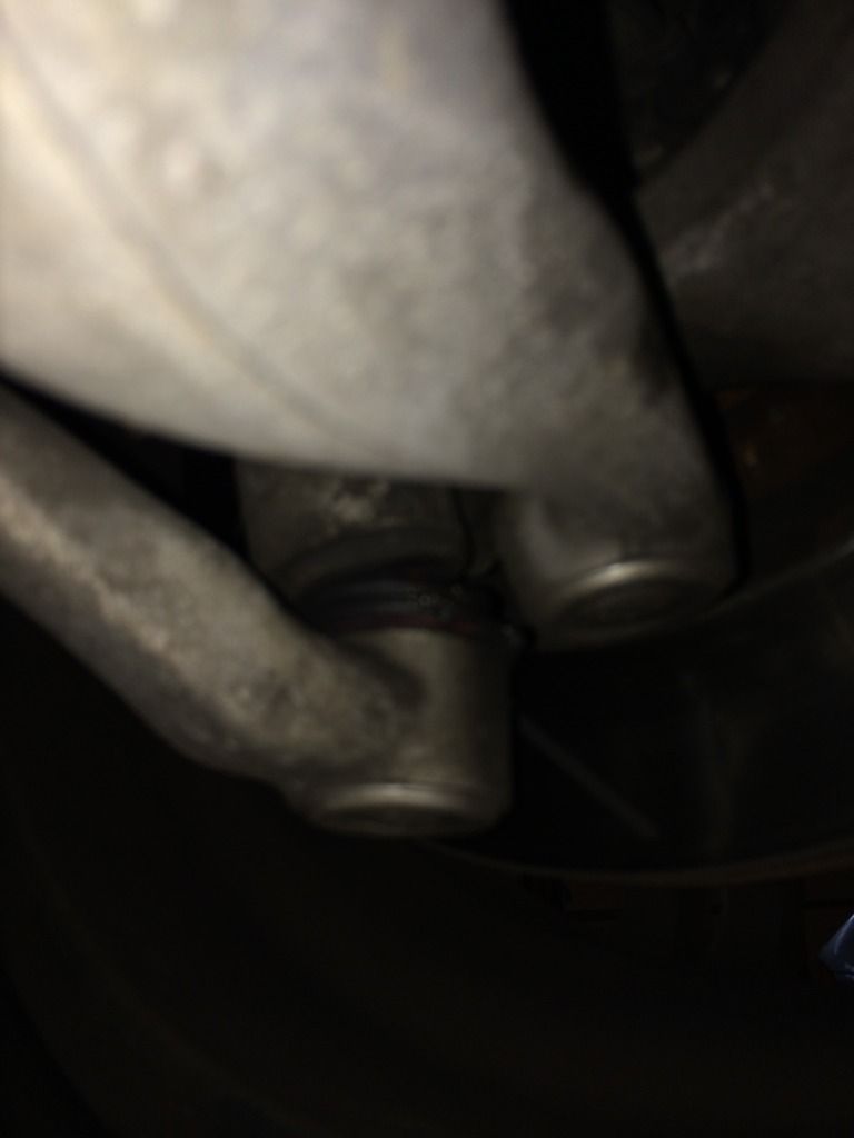

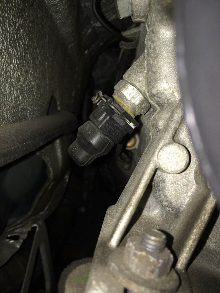

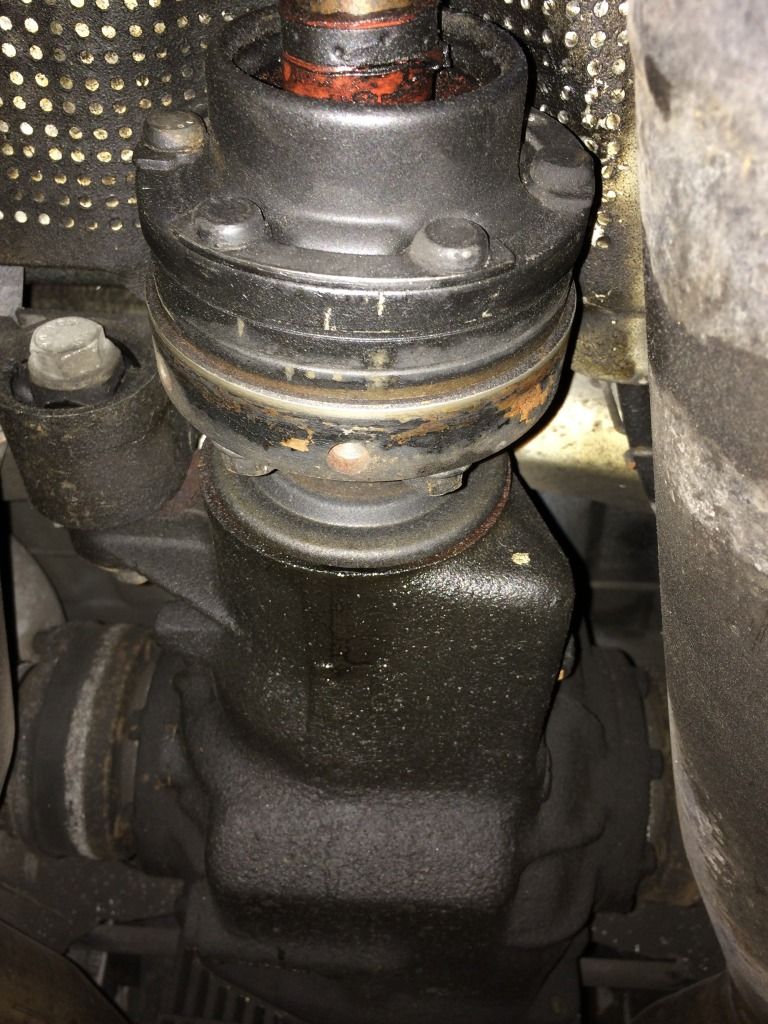

differential input shaft seal is leaking
another ball joint
and another (both on steering linkages)

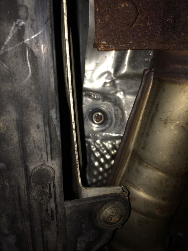

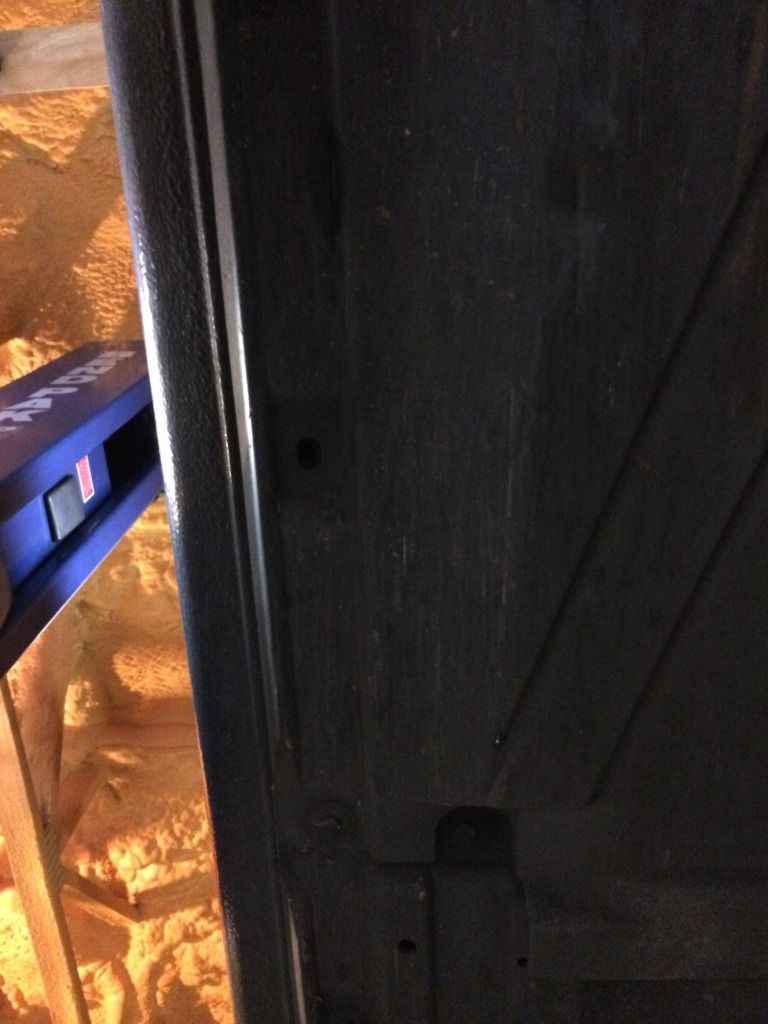

missing body screw mount
and a missing nut
missing side skirt pin

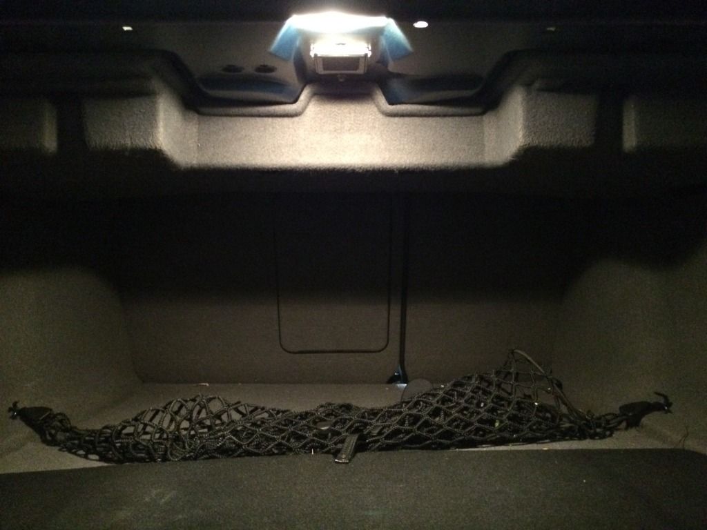

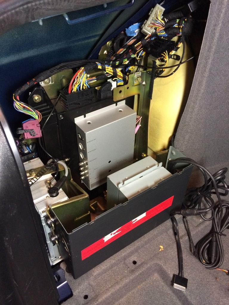

Was also blown away by how much space the non M audio takes up in the trunk (have previously only seen M audio cars).

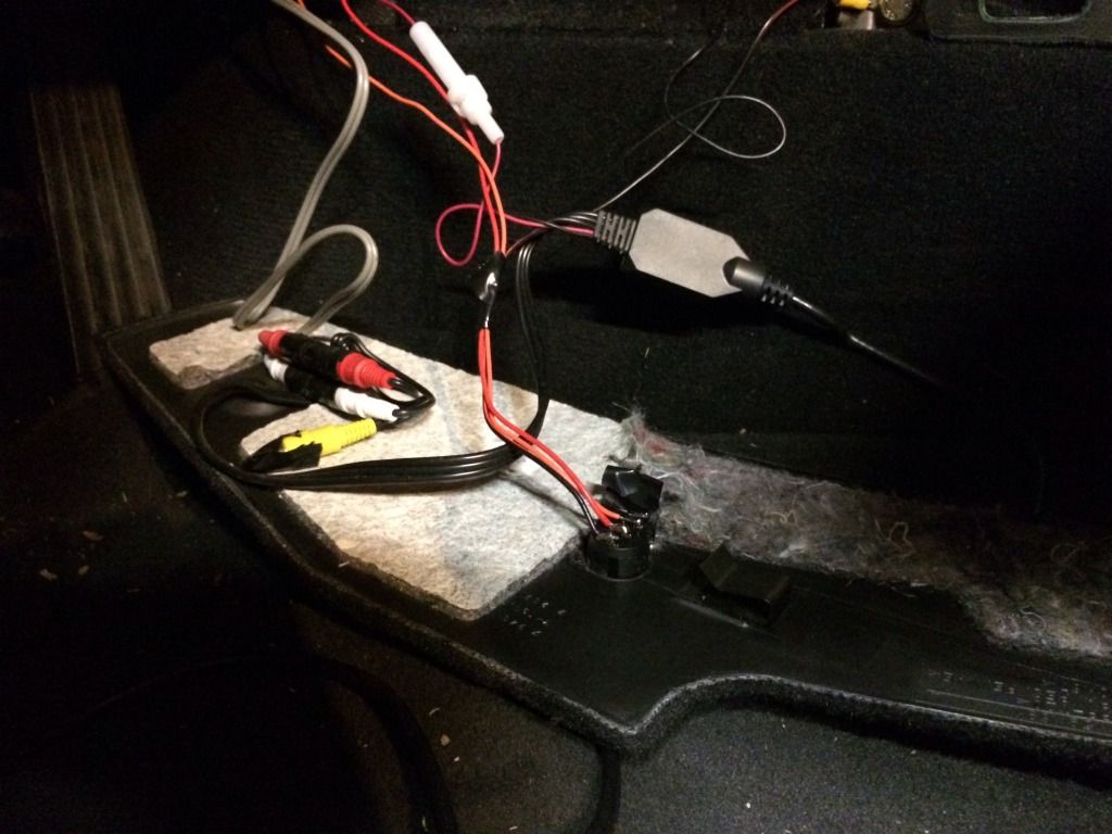

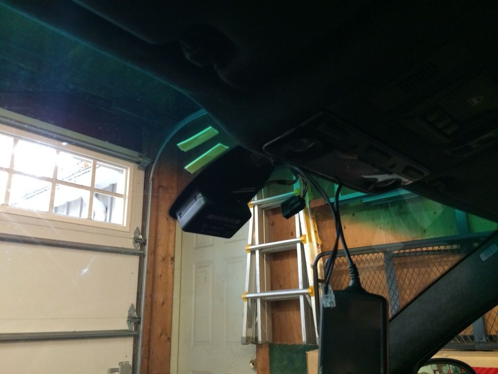

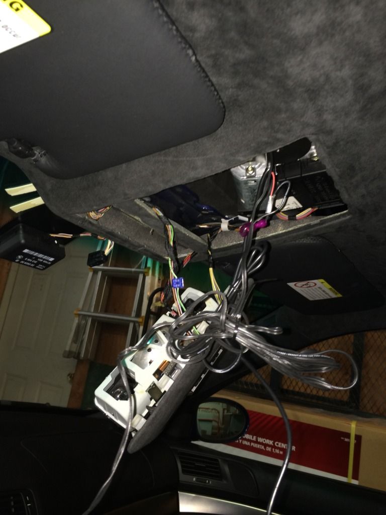

Pulled out whatever used to be hardwired into the headliner. Also ordered a new V1 while will be hardwired, as well as a stealth one will be going up here.

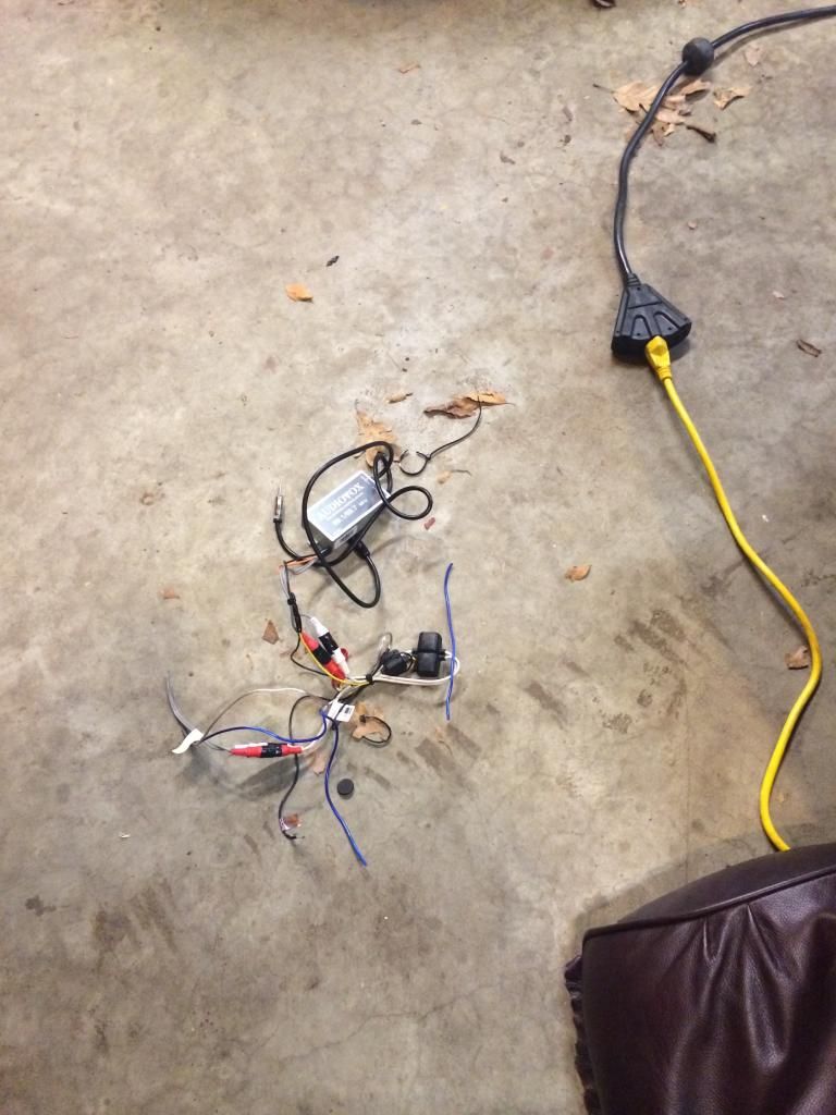

And pulled some misc wires out that I don't know what their function was...

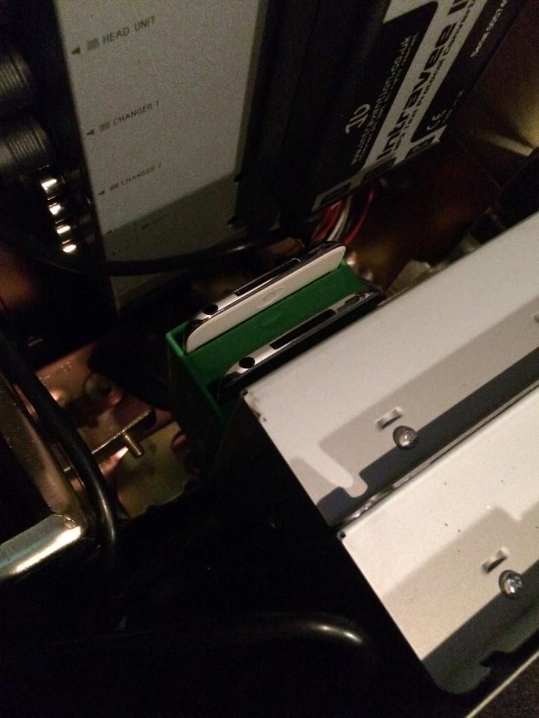

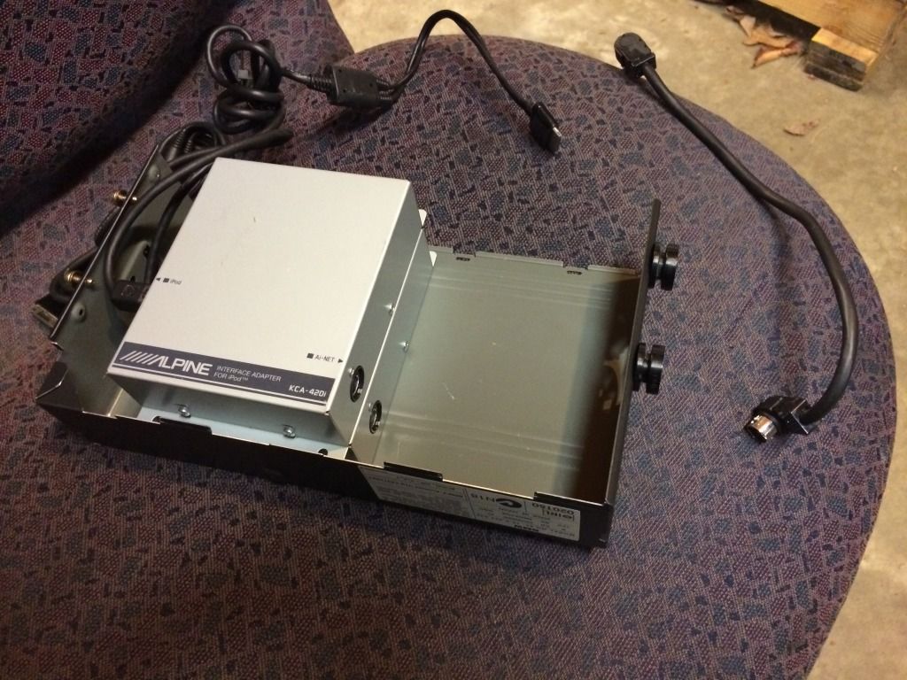

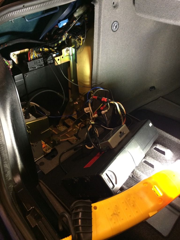

Pulled the CD changer and some sort of FM modular iPod system.

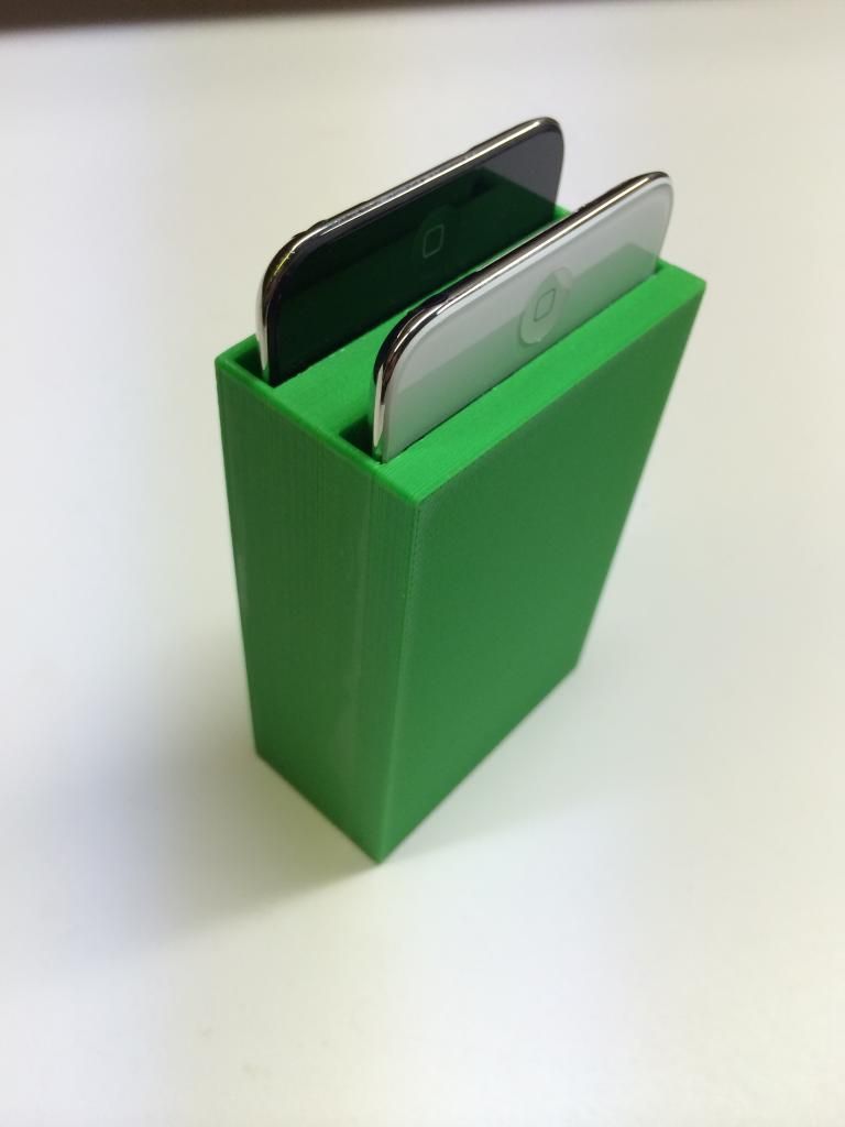

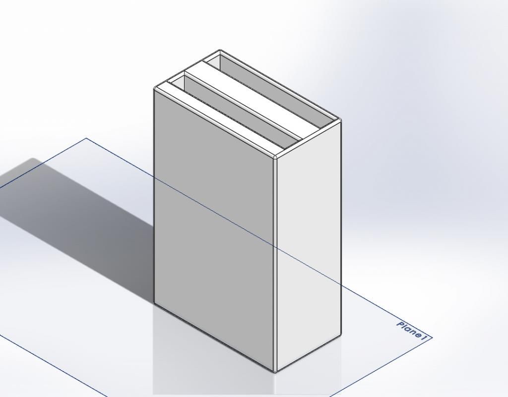

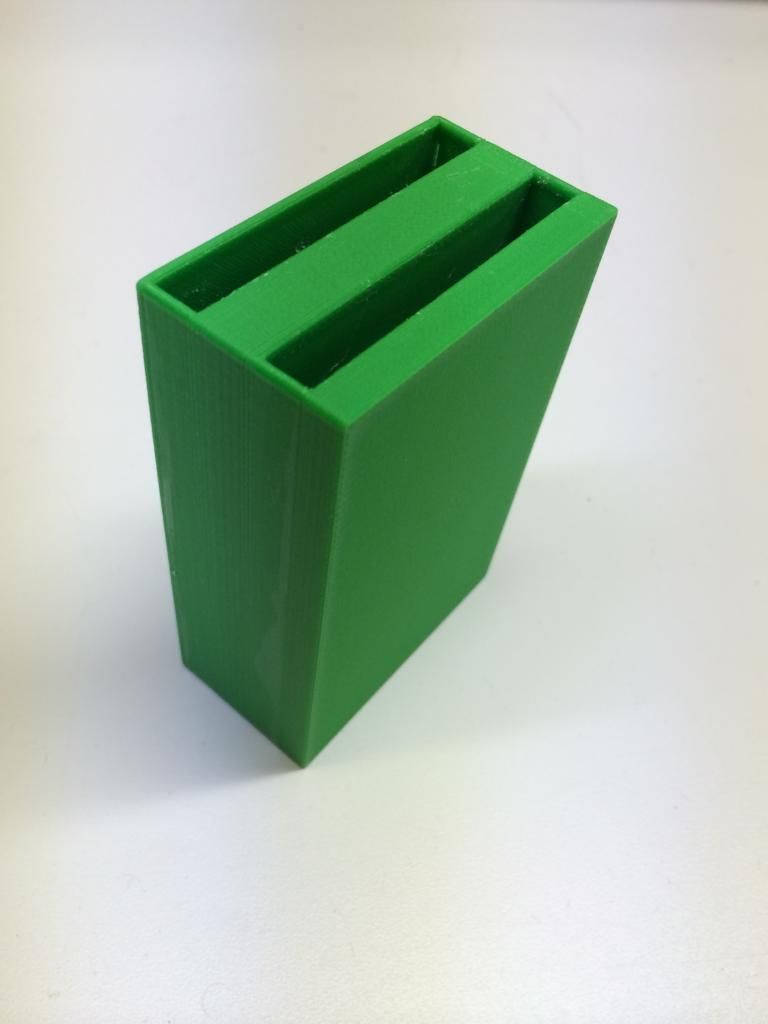

Hollowed out the CD changer and added some alpine components...
and reassembled...
The car is going to have two iPod, and will select the correct iPod based on which key is used to unlock it. That way my wife and I can each have our own seat/mirror/steering wheel/radio presets/climate control/ipod settings, and whoever gets the car will get all of the above automagically adjusted for them.

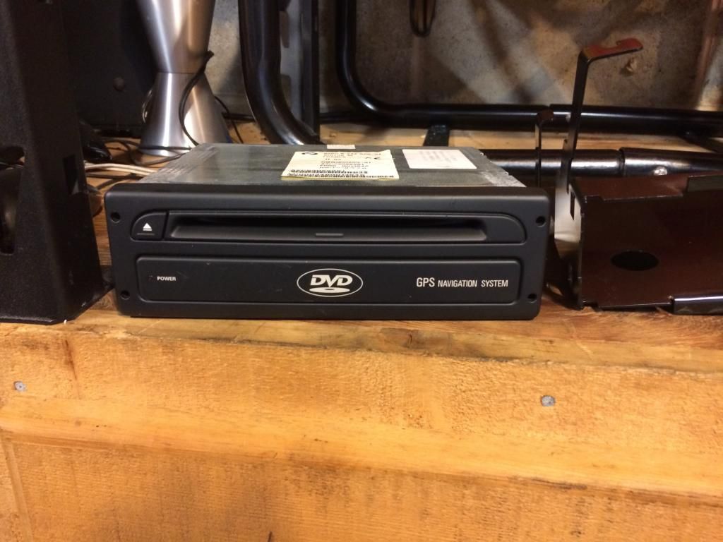

I left the nav out for now because I'm swapping to MKIV, so no point in putting the MKIII back in. Also changing the nav mounting bracket to the one that can hold the bluetooth module, as that'll be going in soon.

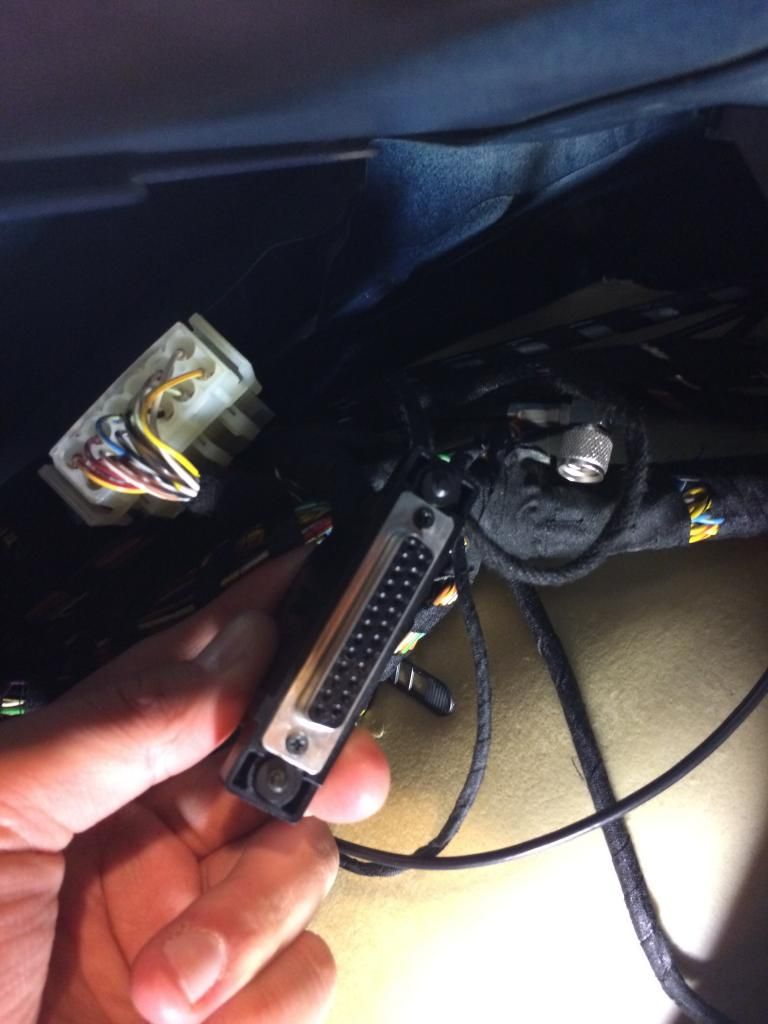

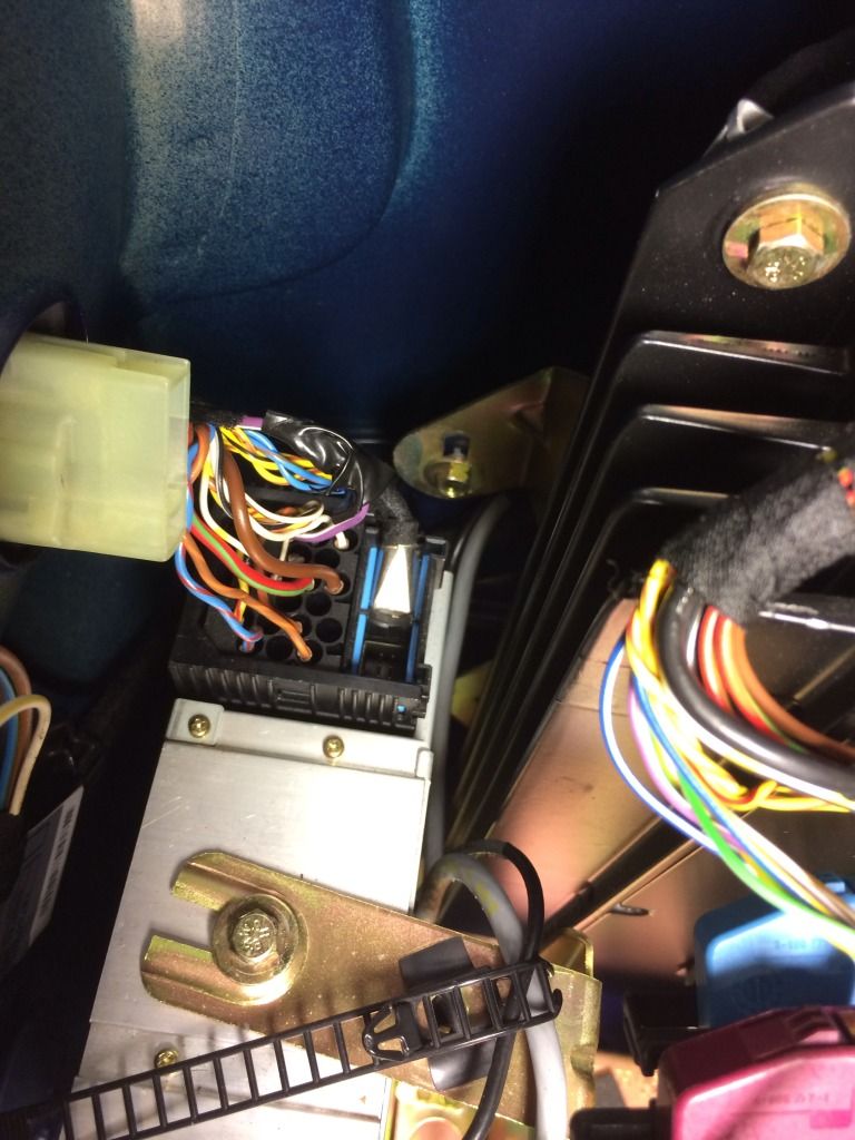

Also came upon this plug, which I've never seen before and looked unlike any BMW plug I've seen before!
Which turns out is pretty straight forward to turn into the standard BMW bluetooth plug...

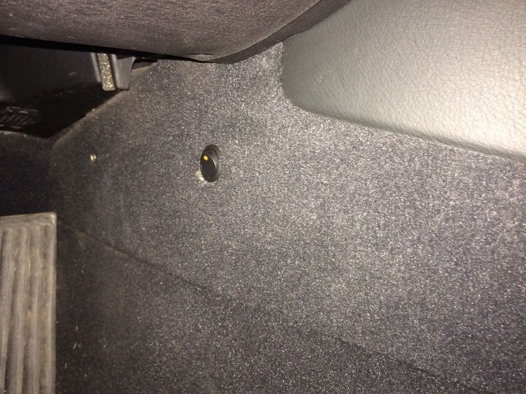

Discovered a mystery switch.
And more wiring to remove behind it. I believe this ends the aftermarket electronics delete (before I add my own) :roll:

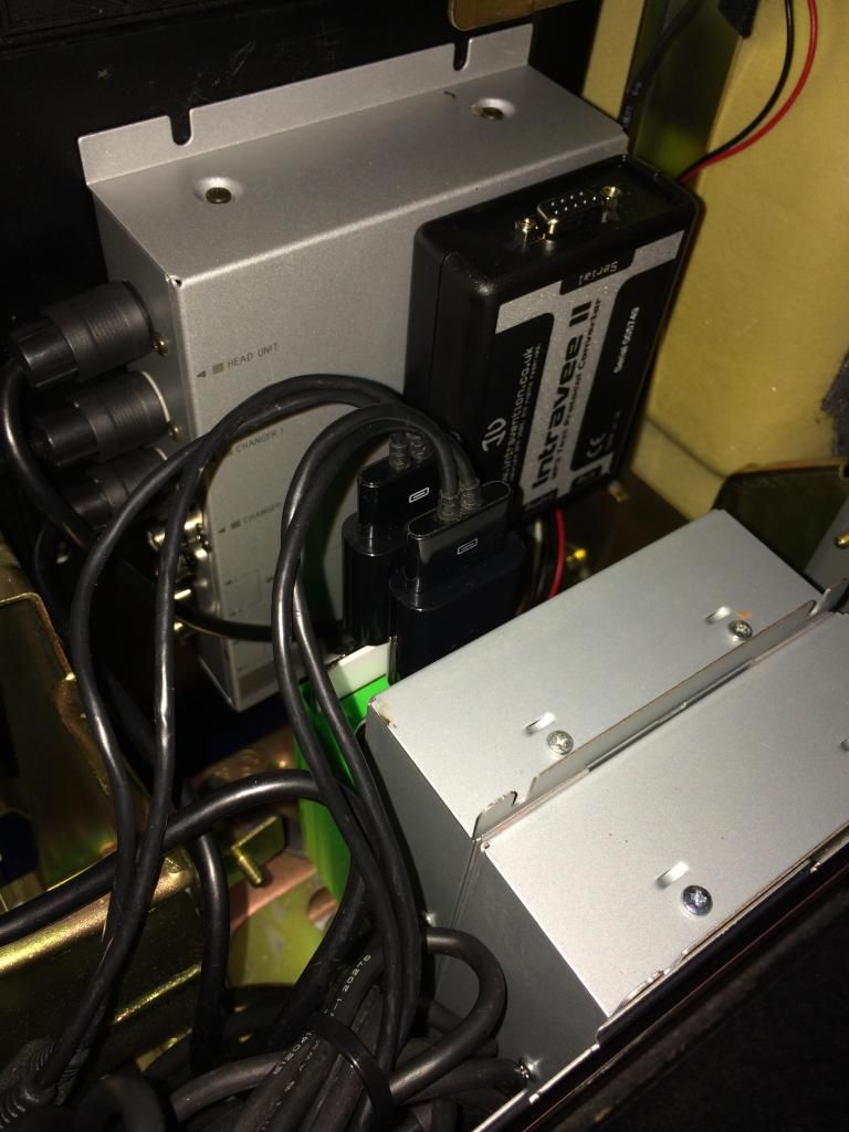

Also discovered the car was too old to have a 6 pin connector for the cd changer/intravee, so ordered an adaptor that'll make one

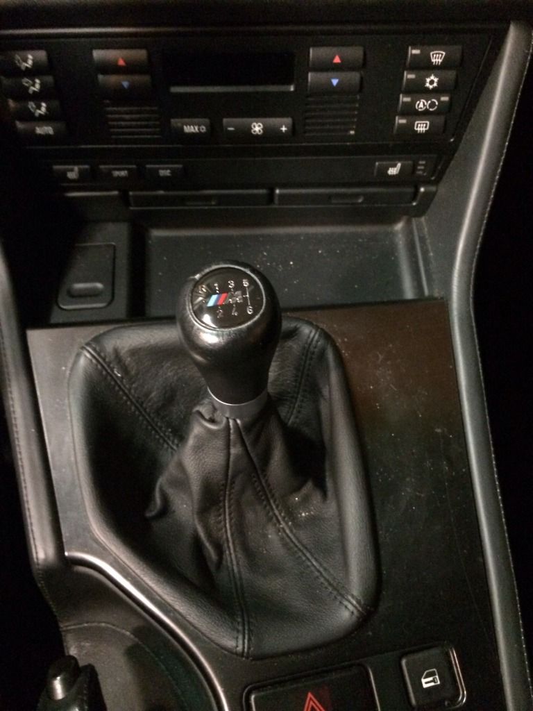

Took some pics of the zhp knob/z3 shift lever, as I'm hoping to no cost trade it for stock and stock...

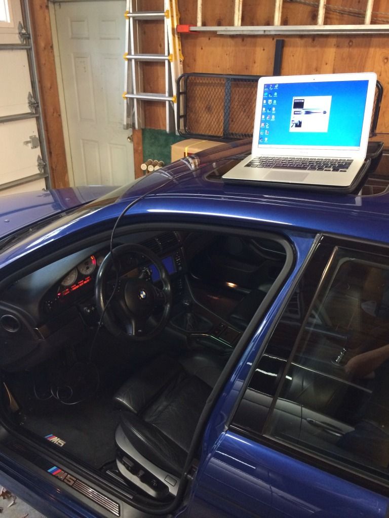

And pulled the evolve tune so sal could tweak things to my wants (car came with an evolve tune already on it/with cable)

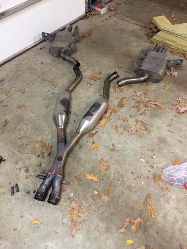

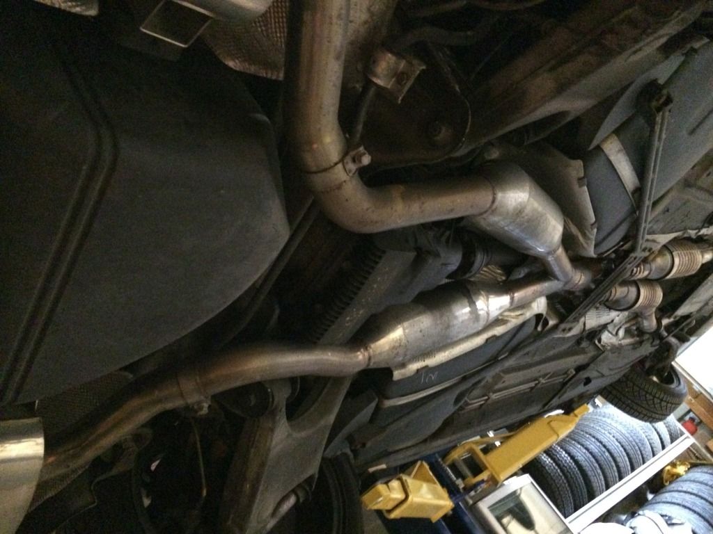

Picked up a stock muffler today (going to sell the Tubi that's on it).
AMAZINGLY huge. This pic is taken in a silverado (full size pickup) truck bed, which couldn't be closed with the exhaust in place!

Boring update, MKIV acquired. :parrot:
Can't put it in yet because I'm waiting on the updated bracket with the bluetooth module mount. Ordering so many parts at once means they take a long time to come. :banghead:

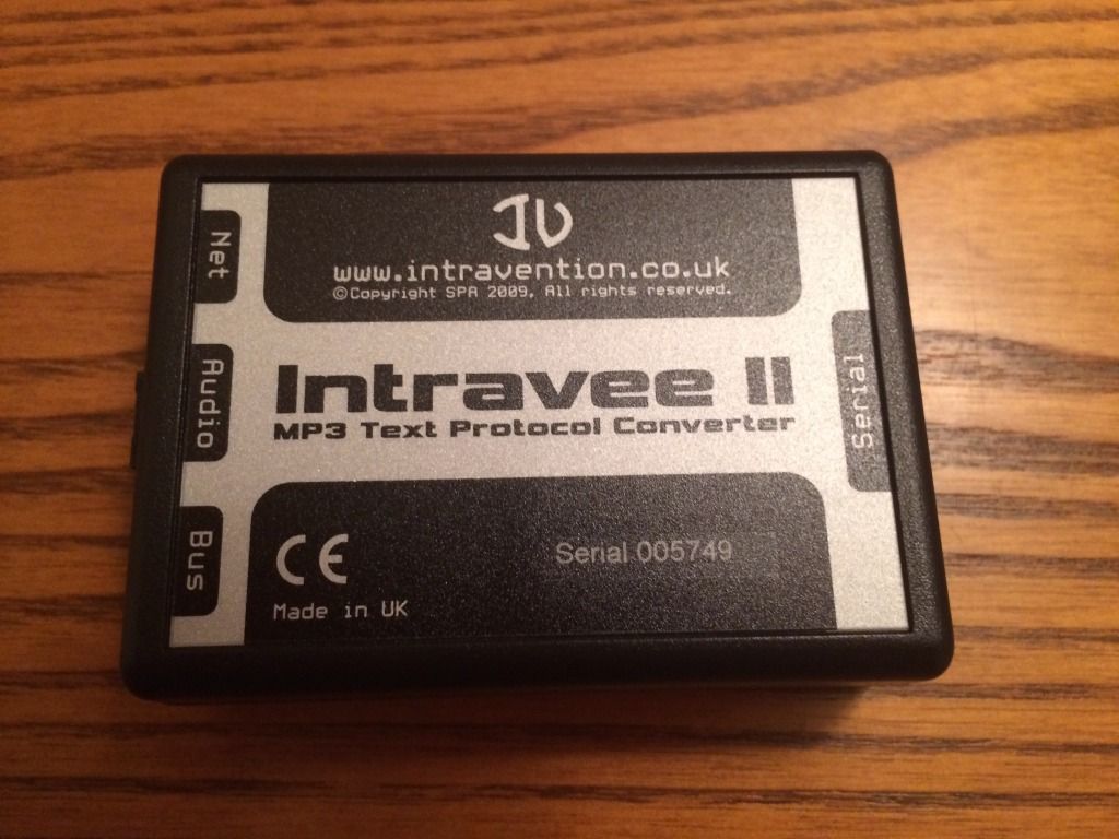

Installed the MKIV with the new bracket with TCU mount last night, as well as the intravee. No pics yet :(
