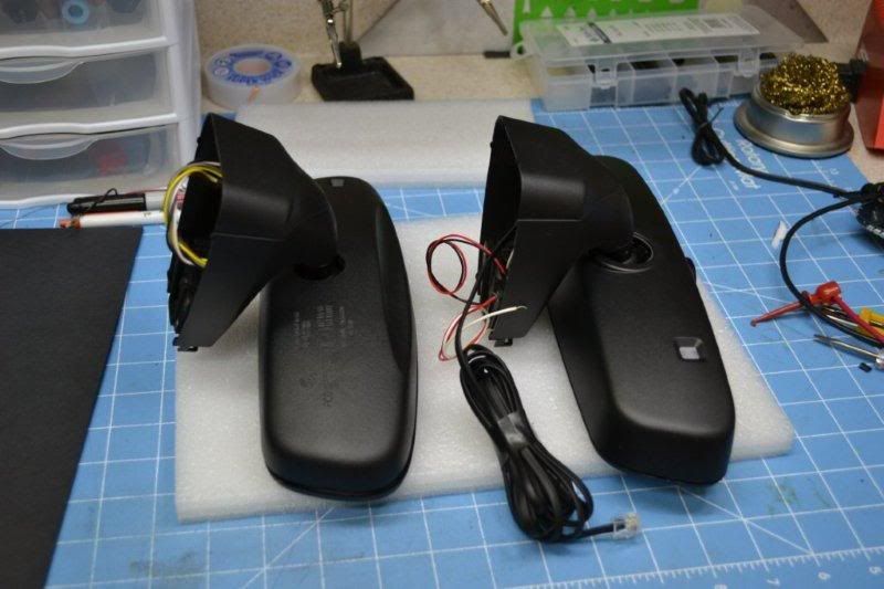

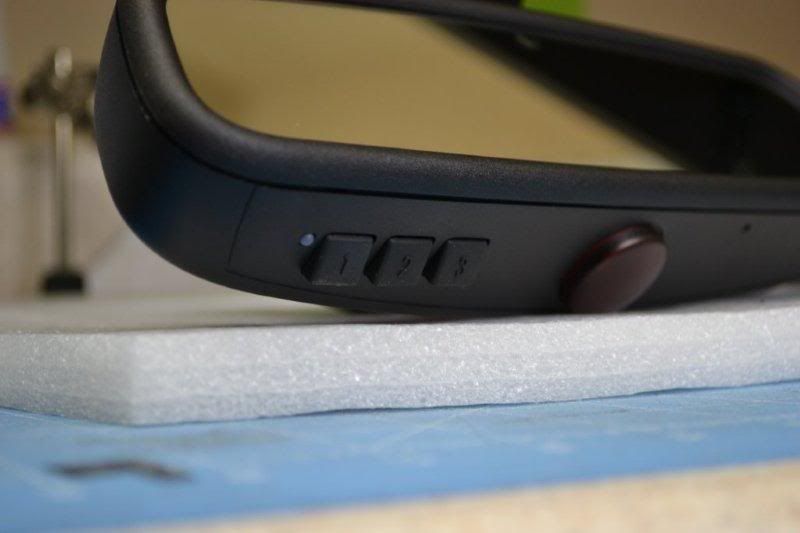

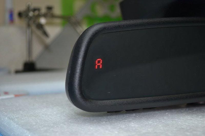

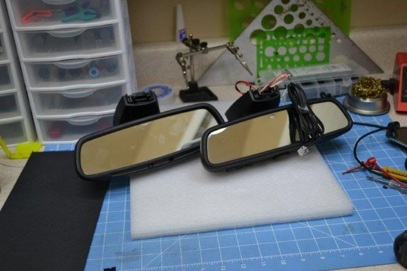

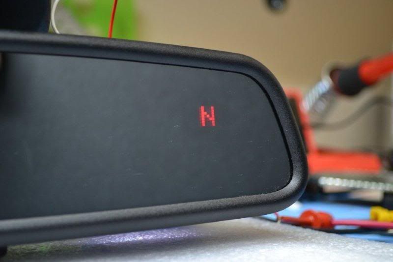

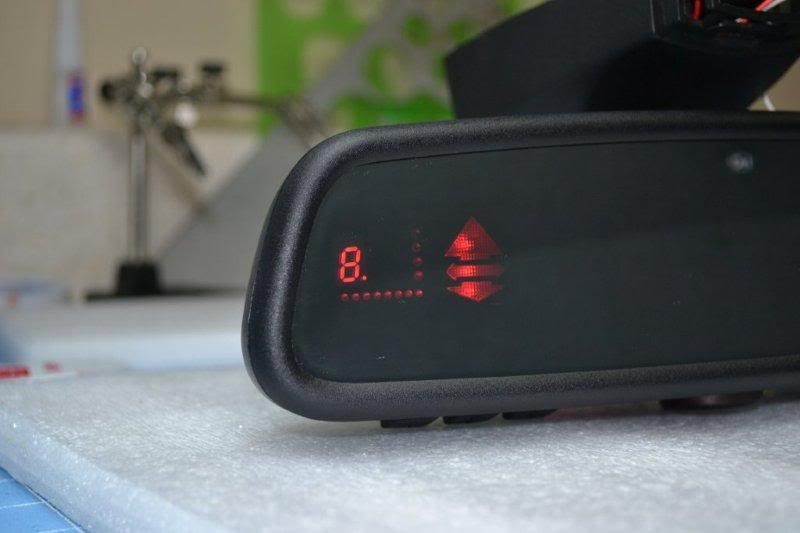

This is a custom build for the owner of a F430. The factory mirror in most Ferrari's is an unimpressive manual dim mirror. The 599 and California have auto dimming mirrors that can be installed in other Ferrari's, but it's a very basic mirror with no added features. Since we were replacing the mirror the owner wanted as many options as possible.. I mounted the factory Ferrari windshield bracket to a factory BMW mirror - the mirror not only has the V1 display installed but retains auto dimming, has Homelink (3 buttons for garages/gates), the red clown nose has an led that can be tied into an alarm system, and the mirror has a compass display that I converted from BMW orange to Ferrari red. :)
