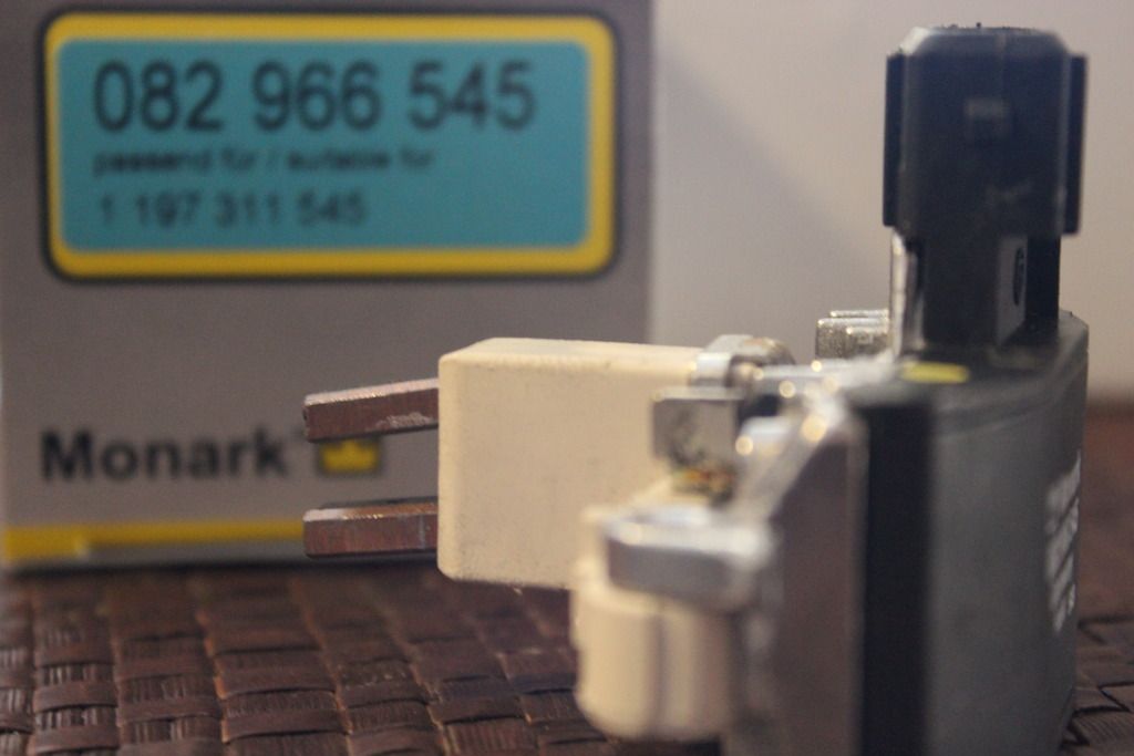

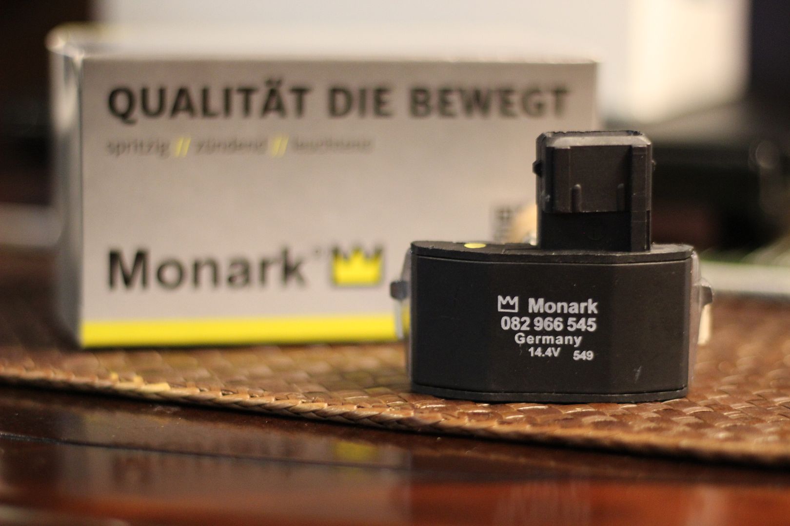

Voltage Regulator - Monark P/N 082 966 545
I got really lucky here. I happened to run across a company called Monark, out of Hamburg, after about 350 hours of searching everywhere for something other than a Transpo Voltage Regulator.
The guy I spoke with at Monark was very nice and extremely helpful. I communicated my desire to avoid a Chinese regulator and my disgust at the Bosch pricing for a new regulator. He did say that they had to move production to China a few years ago in order to stay competitive in the market (which makes sense) and assured me that their specifications are no different than when it was produced in Germany. He also disclosed that final QC is done in Hamburg. Spending some time in the manufacturing industry, myself, I have seen the yields that Chinese factories are capable of when given quality specs. So, I gave it a try and the part is performing well.
Now, the only rub is that there are really no distributors in the US for their BMW line. It took some doing to get the parts over to me but has proven to be worth it. They are currently looking for US distributors for the BMW line and it would be awesome if we could get a forum sponsor to pick them up. I am also testing their ignition coil in a friend's M5 (Mine are all fine) and it is promising.
I'm talking to local people that I am connected with, as well, to see if I can make a connection for them. I also think that they are willing to do a run for us if we can get an order above their minimum (which I believe is 400 Euro). Depending upon time constraints, I may be willing to front the money for this if there is enough interest.
