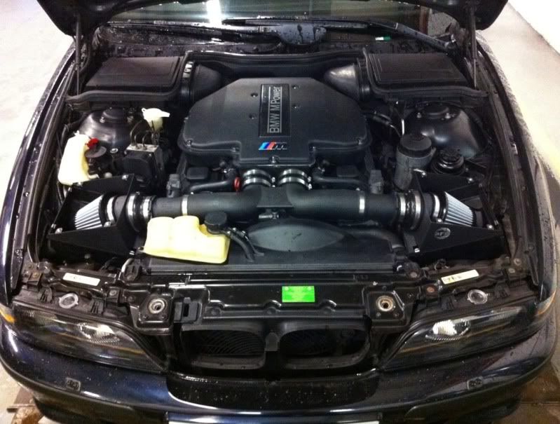

but i felt it was too quiet and too restrained... i was cleaning the bay one day and i knew what i had to do!
so i did it....

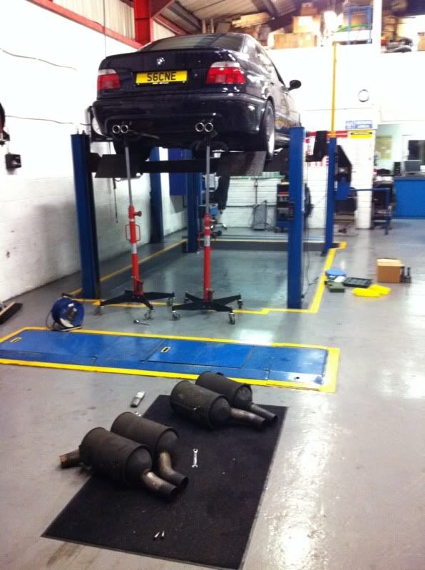

which was a step in the right direction, but not enough... so being competent with metalwork... i took out the rear boxes and fabricated a pair of nice delete pipes :)
the car has been remapped to suit the intakes and now flies! im waiting to get it on the dyno but i hope for a nice improvement - the car made the stock 400bhp before the mods!

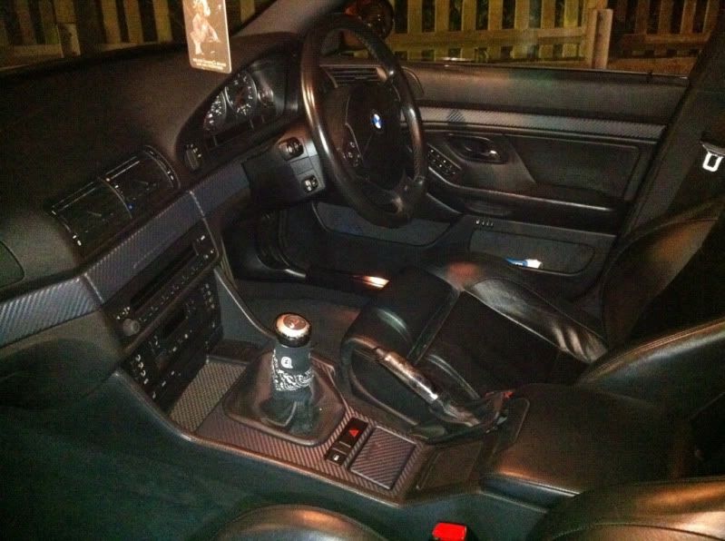

i havent forgotten the interior, and ive wrapped all the alu trim with carbon vinal :)

Excellent introduction. That's the way they all should be. Welcome to the board.
In case you didn't do so already, check your coolant level (first pic). Better yet, if maintenance history doesn't indicate, change coolant and brake fluid. FYI, coolant is every 3yr, and brake every 2yr.

Thanks for the welcome!!! :)
Ive got new pads and discs on order so was going to do the fluid at the same time, coolant is topped but i might change now you mention it, trying to get everything up to scratch.

1,369 Posts
I wouldn't expect to pick up any horsepower on the dyno, the stock mufflers aren't very restrictive and the AFE's just suck in hot air from the engine compartment.
If you want power, save your money and pick up a set of headers and a tune, pretty much everything else is snake oil unless you want to go forced induction. In which case start saving. Now.

as i say i am well versed with building cars, and know the m5 as a superb airbox setup - the box deletes and intakes are purely for the sound + enjoyment of the drive.
im well aware it wont pick up any power. but power is not allways why we modify.
the software remap WILL give power however, i do some custom remapping myself on alot of opel and VW/Audi cars and a friend of mine in SA has alot of experience with these m5's for customers in dubai. it has his tune on it right now so excited to see what he's managed to produce, it feels more spritely and throttle response and smoothness is much better anyway!
145 Posts
Hi and welcome, that's some tasty mods you have done - especially the backbox removal. Who did this for you and how much was it if you don't mind me asking? Does it sound alot louder than stock..??
I'm interested in the muffler delete but I don't want a constant drone/hum sound in the car, only when I give it some gas then I want to hear the roar of the V8..!!!

hi harry!
i did it myself, the sound is as per the 'muffler delete' thread really, keeping the centre resonator takes care of all the nasty drone on the motorway and at idle/part load etc but removing the back boxes ups the sound level and quality - sounds just how a V8 should sound now, throaty and a very deep roar!
im very tempted to make up my own x pipe but im very aware i need to keep the noise down to make it out to any of the UK tracks. for the sake of a little noise i think i would prefer an easy entrance to the tracks...
I was quite time consuming to get it really nice, i guess overall it took around 4 or 5 hours to do and the tips and pipework, clamps and brackets came to around £170 :thumbsup:
it's not something we would generally take on at the shop but if you were local im sure we could do something for you - im not here to sell though.

Looking good those pipes, think I need to get some brillo pads on mine as the tips look rubbish at the moment...!!! :7:
I guess the sound on the dyno is going to be different, will be different if you just rev it while parked - good stuff though.
