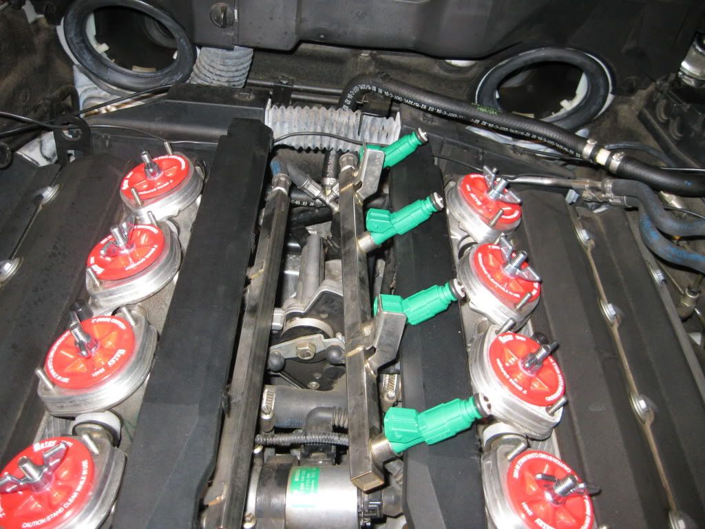

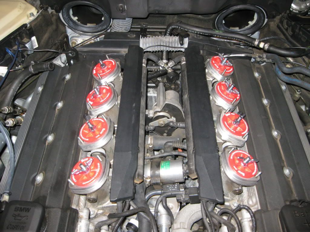

I did mine and can give you the basics.
First, remove the 10,000 nuts and bolts holding things in place. Remove the top of the intake manifold cover. Then remove the 8 trumpets(I labeled mine with a Sharpie so I knew the order to re-install them). Next, the bottom half of the intake manifold which is bolted to the throttle bodies. You will have to loosen 4 clamps which are below the two big air intake holes: the Idle Control Valve, the hoses for the crankcase oil vents, and the oil return line. If you try to lift the intake manifold, you can see the hoses stretch a little and know what you have to loosen.

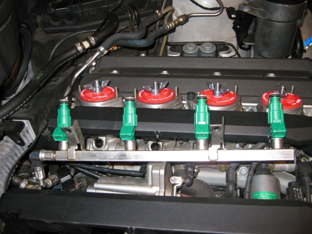

Next you have to unclip the electrical connections to the injectors. It's been awhile but I'm thinking this is where there is a pesky little clip that I had to use a dental explorer to tease the clips off. Then remove the bolts holding the fuel rail in place and pull up on the rail. The 4 injectors should come out with the rail. Undo the clips holding the injectors to the rail. Remove injectors, install new injectors to rail with clips. I slightly lubed the rubber o-rings with silicone grease at both ends first to help them slide back into their respective places. Line things up and re-install fuel rail. Then make sure you properly re-install each electrical connector with a "click" to each fuel injector. It sucks to have to go back in once everything is buttoned back up, ask me how I know.
Go backwards from here, intake manifold bottom, tighten clamps, 10,000 nuts and bolts, etc.
I didn't take too many pics. Here is part of what you'll see, fuel rail on injector:

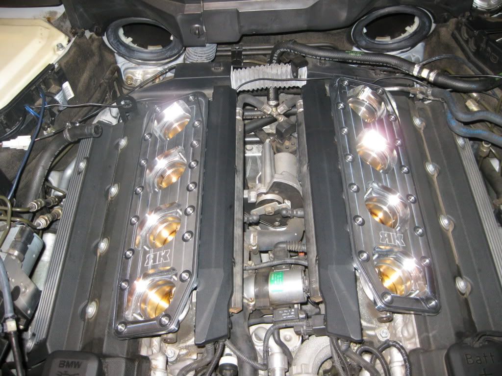

Mine will look a little different because I was also installing RK plenum plates at the same time:

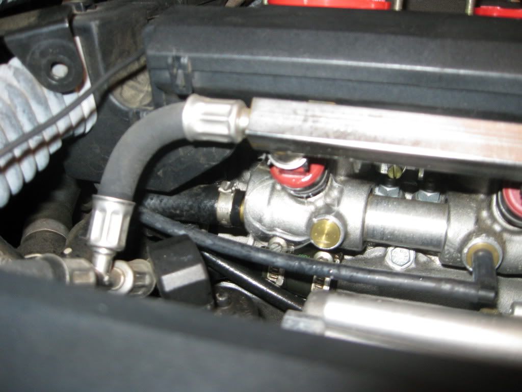

And my throttle bodies were plugged up because I was also doing some boost leak testing:

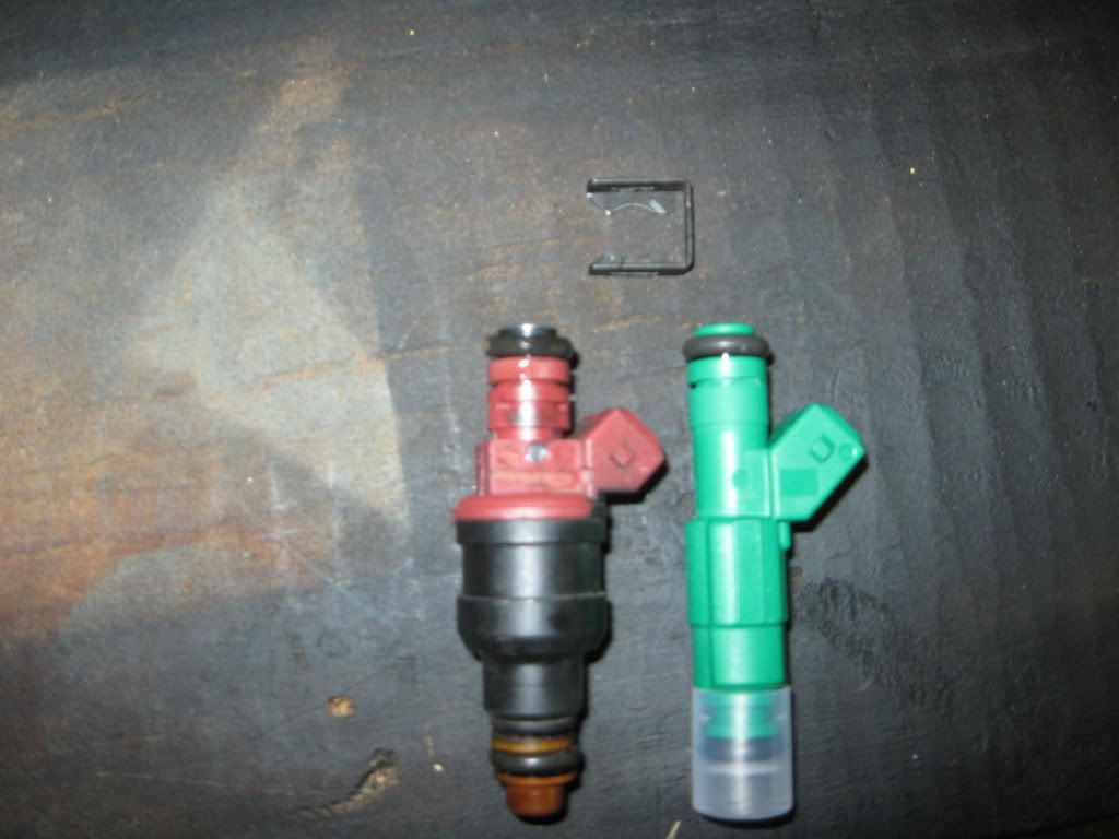

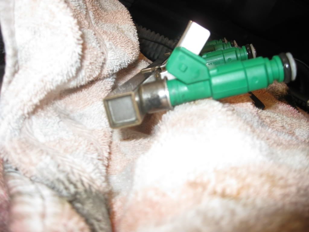

And I was replacing the ESS supplied injectors with Bosch green tops, this is the clip that holds the injector to fuel rail:
Here are a few more pics:

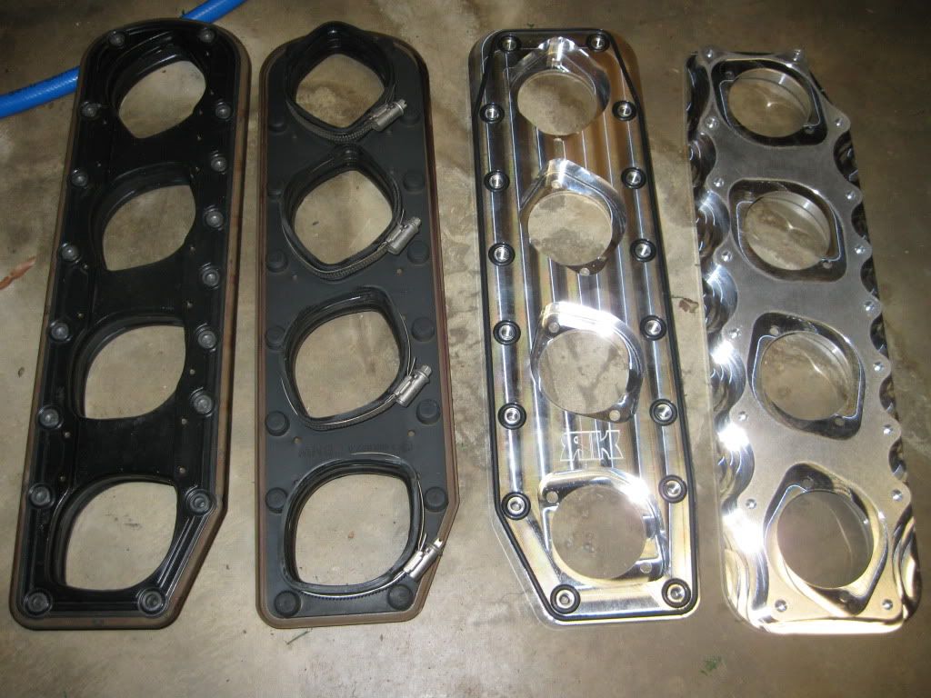

what is difference between the other gaskets? say the two straight pieces.
Do you mean the plenum plates? On a naturally aspirated car, I believe there is little if any positive pressure in the intake manifold because the engine is sucking in air. So there is no chance of leaking around the stock plenum gaskets. In a supercharged car, we may have 6-10+ PSI depending on the kit, and there is a chance the plenum gaskets may leak with this much positive pressure. The plates help eliminate boost leaks. Sorry if this is not what you were asking about.

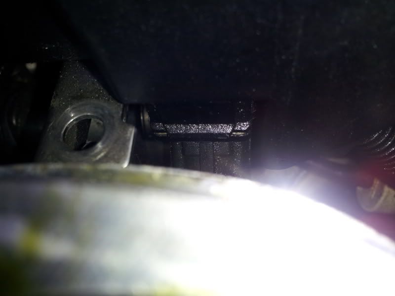

I used a pigtail dental explorer to remove them.

Thanks, figured that out finally lol_ took forever to realize that you pick it-then slide it back slightly
then of course after spending all day getting the passenger side clips off, upping putting the rail back all the clips pops off into oblivion.

Tip to others, there is a little fuel that spills out of each injector when you take them off, so have some towels ready.

Ok the injector it self, there is one o-ring on the top and 2 o-rings on the bottom? from the picture it looks like there are 2 o-rings on the bottom part? Can somebody confirm? Also the o-rings for the bottom part are really expensive, (13647830611) $12.00 Each. Do I need to change these or can I reuse my old ones?
#19 ·
One on the top and one on the bottom. They are different sizes.
These are standard bosch injectors, you can get new o-rings from any injector cleaning place, or even try e-bay, for much cheaper.

and that dental tool, works great, you can get a few of them from the $1 store, they break easily, Also I needed to buy a few extra leads off ebay, as I kept losing those darn small metal clips on the injectors. The injector closest to the firewall is very hard to get the tool in at the correct angle. I lost like three of those darn metal clips lol
