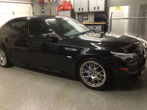

Hey guys, I have been around for a few years now, but I thought it was time I started a build thread for my latest ///M car. I bought this 2008 M5 back in December to replace my mint 2003 M3 I sold. I decided I wanted to finally own the famous V10 Jermey Clarkston talked about years ago on Top Gear. I was very lucky to stumble upon this car on Autotrader as the owner had only posted the ad a couple hours earlier. It is a 2008 M5 fully loaded minus soft close trunk and rear heated seats. The car had 59k miles on it, but the owner had just performed a tons of maintenance/mods. The car came to me as a 21pt Dinan car. Dinan Stage 3 Software, Dinan Intakes, Dinan UDP's, Dinan section 3 mufflers, Dinan 3.91 LSD, Dinan Stage 3 Suspension, BBS CH-R 19x9/19x10.5's, and Weisher's LED interior/exterior kit. The owner had just replaced all the rotors with OEM's that he had Powdercoated silver to prevent any corrosion. He also had the calipers custom painted in a metallic blue that matches the BMW roundel blue. These also received fresh stainless steal brake lines, and Cool Carbon pads. The car was like brand new as the previous owner only drive it on weekends or in perfect weather. The car spent most of its time professionally detailed and under a car cover. He included 2 really nice car covers, and a OEM BMW trickle charger. These were the pictures when I first got the car in December.
