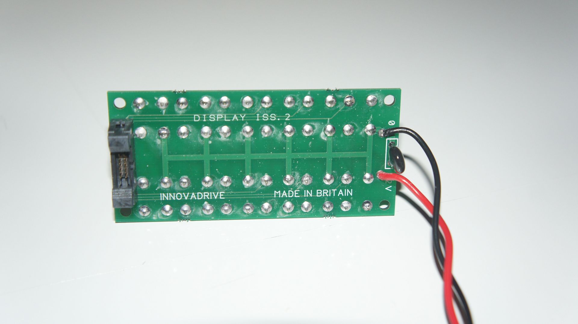

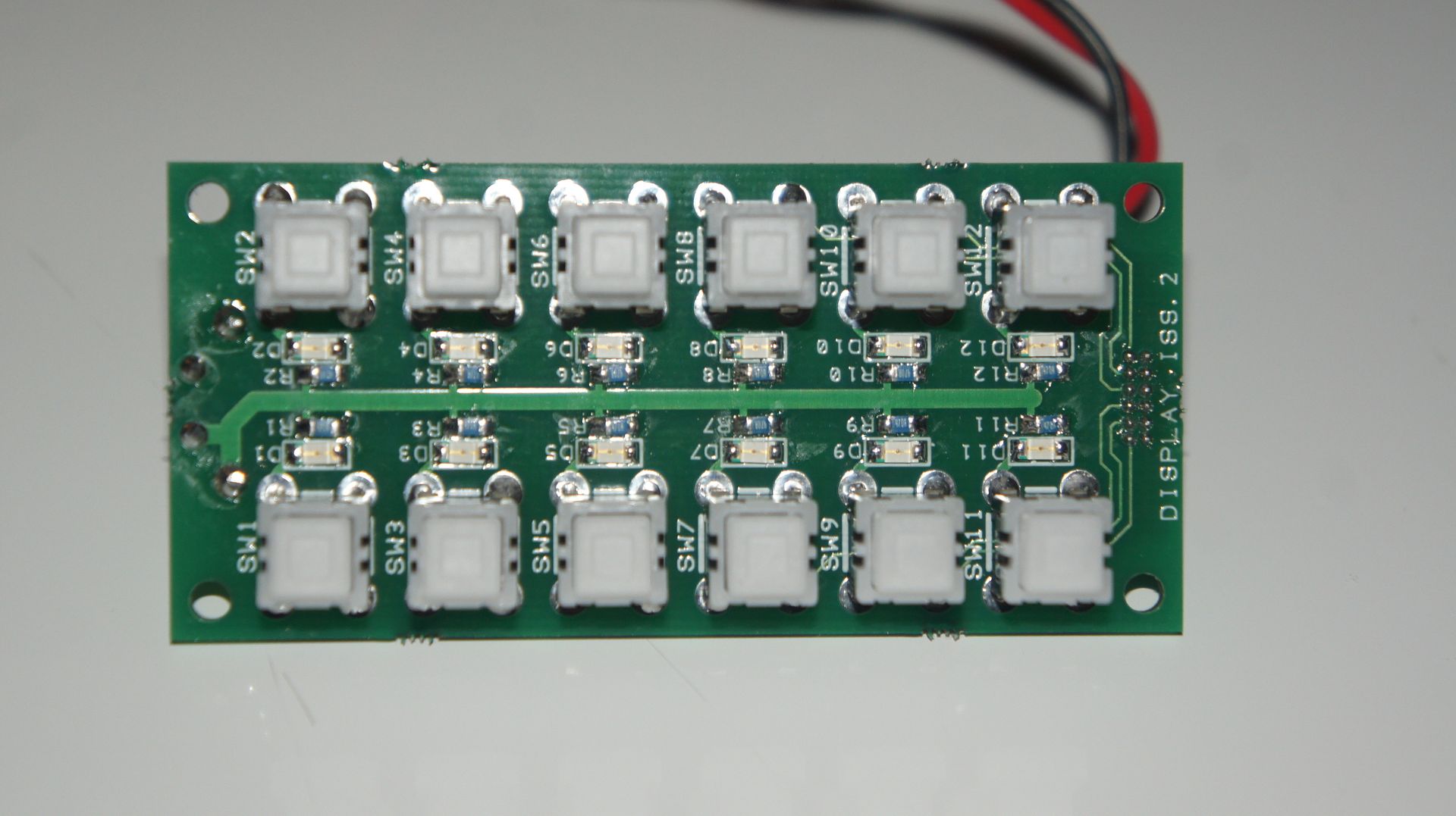

6) The buttons are pressable, backlit & dimmable, and the PCB has a connector in order to be able to attach wiring. They are purely for aesthetics (the volume knobs too). Dimmable backlighting when connected to the car's loom is integrated along with a close resemblance to the car's original dash backlight color.
