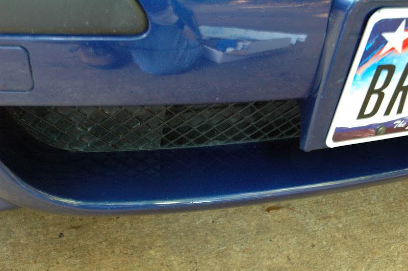

OK, enough talk. The good news is I took before and after pics. The bad news is I tried to avoid using the flash and forgot to really bump the ISO up to get a lower shutter speed resulting in some blurred pics. I did the hood and trunk lid too. Here are a few sample shots and a link to more on Picasa.
Before:
After
even though the chips are still there and up close you can obviously still see them, when standing by the car you wouldn't really notice:
