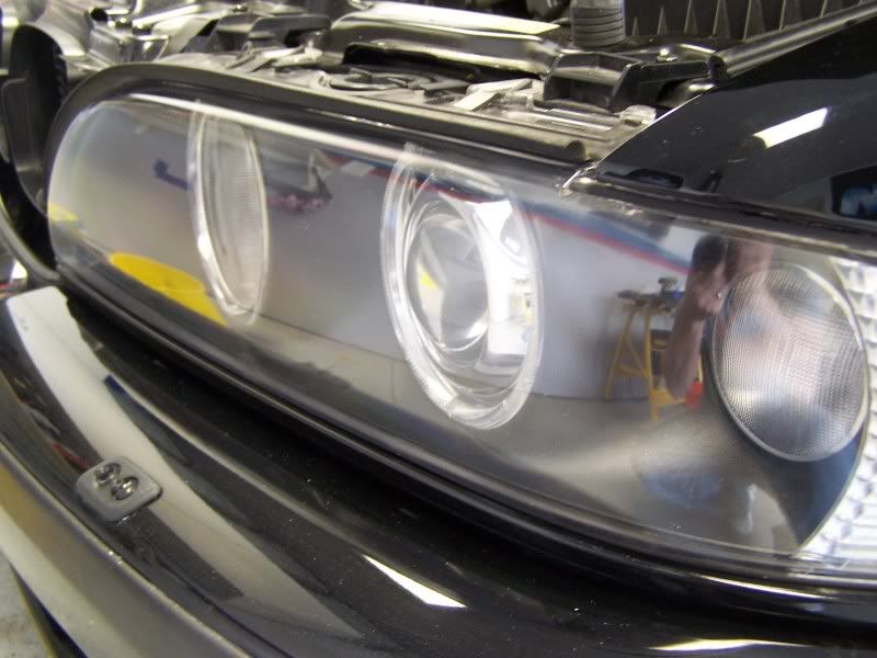

Your Angel Eyes will always be on as long as your key is turned onto position 2, the headlight switch no longer controls them, so yes they will still be on. But if you have your car turned off and your headlights on, no they will not be on.
pics of headlights tim?
Will do....

Raza, best I have right now.....
