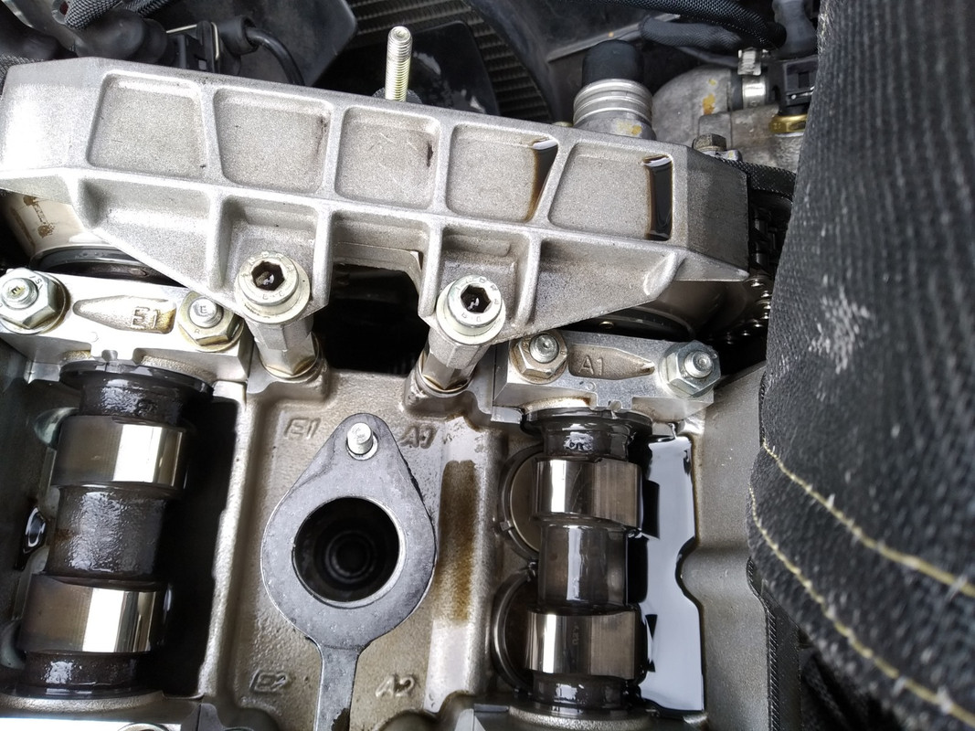

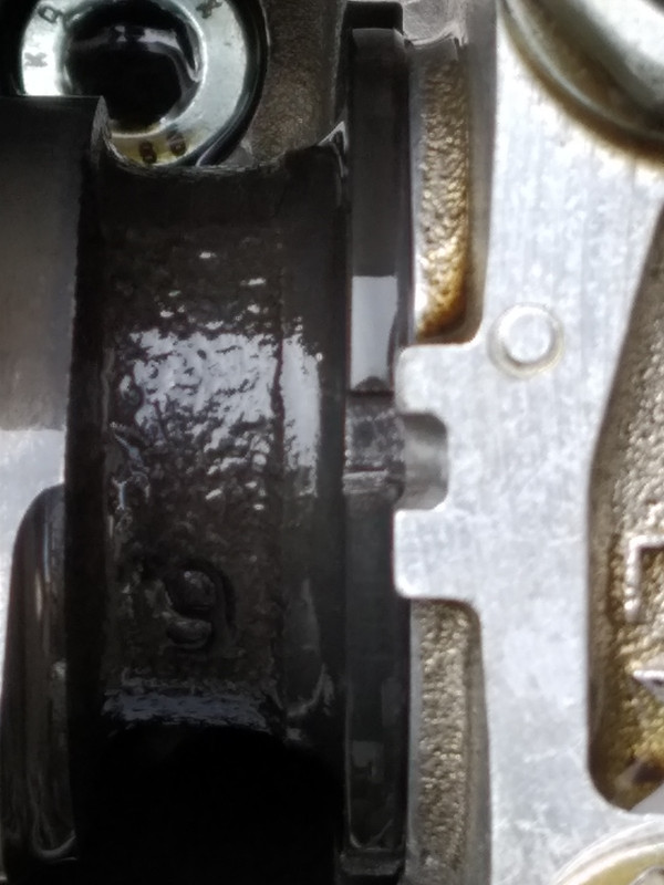

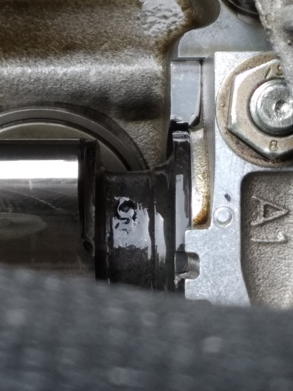

Want some help regarding cam timing. I put a thicker MLS gasket and timed the motor but one of the marks (intake) is slightly off, but as you know we are limited to changing a teeth in the sproket so I want to know if you consider this difference acceptable?
Actually, a little less overlap is not too bad for a turbo engine...
Here are the pictures - crank is at TDC, Exhaust cam is spot on and Intake cam is the one slighly off.
Slightly off intake
Spot on exhaust
Another picture of intake

Your timing is slightly off (advanced) but not within a tooth of the cam sprocket.
Does it inject fuel and does the spark plug work while starting?
Advanced intake timing in general dis-improves idling and top end torque/power but improves mid range torque.

Totally normal when installing a MLS gasket. I have assembled 2 motors like this and they ran just fine. You could get slotted gears if you want it perfect.

Thanks a lot! Its running again.
Problem was with the mapping in the ECU - crank and cam trigger settings.
