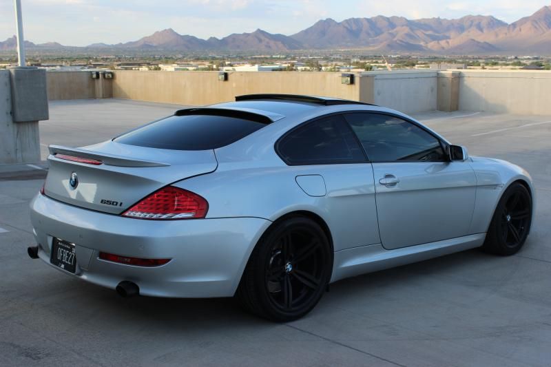

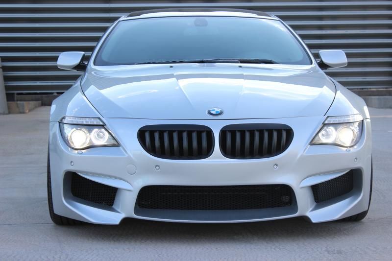

Finally done with the mods- let me address what people have been waiting for the F13 M6 Sarona Front bumper.
This front bumper is from Sarona Designs- very reasonable price, fitment was perfect & there are virtually no gaps at all-
Only work that really had to be done was cutting both edges of the Reinforcement bar on the front bumper, this took the body shop 10 mins to cut those edges off. The bumper comes with the mesh that you see already installed. As you know these cars have the fog lights, so you can either get resistors when you remove the fogs, or you could just remove the fog light housings but keep the bulbs connected to the car & simply tie behind the bumper so you dont get a warning light on dash.
The bumper is sturdy & was shipped to my door step from NY to AZ within less than a week, i'm very happy with the bumper & the support the company offers, i had many questions and concerns when i got the bumper, and all were addressed and explained rite away.
Now back to the mod list:
*F13 Sarona M6 style front bumper
*Rear Roof & Trunk Spoilers.
*H&R Springs.
*OEM M6 Wheels. Powder coated Blk.
*Spacers Fr:10mm Rr:17.5mm
*Muffler Delete w 3.5" Blk tips.
*Black Kidney Grills
*Window Tint.
*Angel eyes
*LED License plate lights.
*Black 650i emblem.

Nice clean update... can you please upload a few pics of the bumper's connection to the fender and the hood?
Thanks
265 Posts
Discussion Starter #8
Thanks
sorry for the late reply, i have a video on youtube you can watch that gets close to those parts
