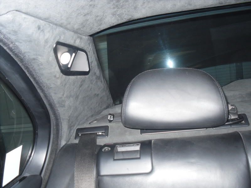

I purchased my BC Racing Coilvers (Type BR, 8k/6k spring rates) from Tristan at Circuit Motorsports. Great guy to deal with. I also purchased the rear extenders for the damping controls. I installed the rears first, the harder of the 2 to do. If you remove the fender liner, it really isn't THAT bad. You just have to remove the caliper, take the upper rear trailing arm loose from the knuckle and disconnect 1 plug to slide the shock/spring assembly out. The fronts are SO EASY it isn't even funny. Once I get the ride heights at all 4 corners squared away, I will do a full review. I am starting my dmapening setting with 10 clicks from full soft in the rear and 15 clicks from full soft in the front.

Rear extender install, you can see where I intended to put the extender knob out through the speaker grill but it bent the cable too much that you couldn't feel the "click" of the settings, so I had to move it up a little. I will just source some new speaker grills to take care of that hole.

I too have the extenders and was wondering if you could put them anywhere through the speaker grilles.
Obviously the corner is a no no but do you think you could do it more central in the grille, perhaps where you have positioned the holes in the shelf but a little further back so as they are on the very front edge of the grille??
I was going to do that, or leave them in such a way as they are tucked under the grille itself and i could simply unclip the grille for access to the extender.
Having done the job now do you think any of that is possible as i want to leave the shelf unless its a last resort???

I am sure it could be done, but I am not sure you would be able to feel each "click" of the adjuster. Where I had mine it worked, just not the way it was intened too. Look at the picture with the speaker enclosure mounted. You will have to go around that to get where you want to go. That will be your issue.....
