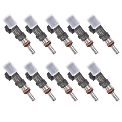

As mentioned above replace all spark plugs and possibly coil #5. Instead of replacing all coils do this favor and replace all injectors, they could damage the engine with no warning. Here a link of an OEM original Bosch, this is a very good deal you will not find it anywhere.
I bought a set from this seller 6 months ago for 230$ now it is 185$.

I'm going to take everyone's advice to replace all the fuel injectors and spark plugs. The cost of the fuel injectors and spark plugs is $250. Since I'm doing the labor myself. It would be foolish not to do it all at once. I am going to order a spare ignition coil pack is well. Just in case I have a faulty one. If I don't have a faulty one I'll just have one on hand as a spare.

The spark plugs and fuel injectors I ordered early this week arrived. I started by changing the spark plugs 1-5. While doing that I swapped the ignition coil pack between cylinder 4 & 5.
I started the car and I got a different code: 2B45. This time it is for cylinder 4 instead of cylinder 5. I think that means I have a bad ignition coil pack. That is the 2nd bad one I had since renovating this car. I have only driven it 3K miles. Plus the guy who I bought the donor engine/transimission from reported having to replace a ignition coil pack not to long before he crashed his car.
