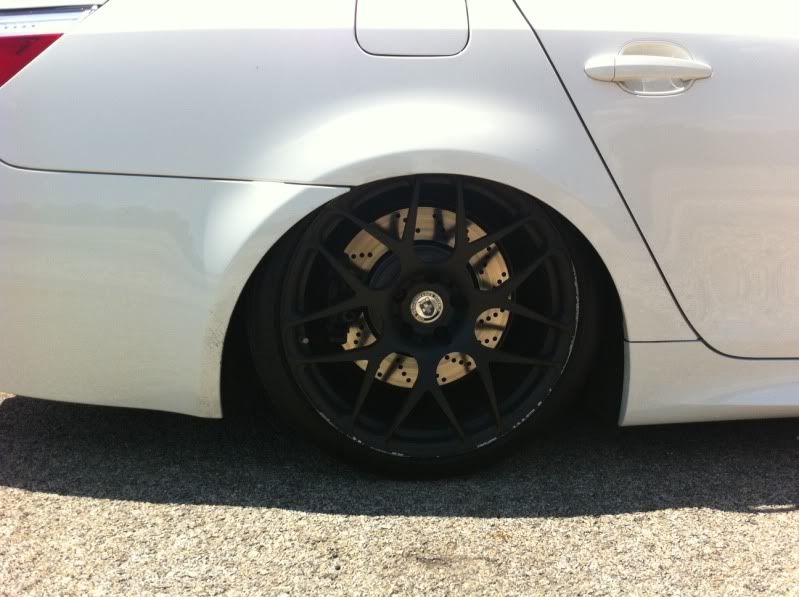

So I was driving from Houston to Dallas for a meeting... I was about 130 miles north of Houston on 45. I was doing about 90 passing a car when I here a loud BANG and some serious noise from the right rear... slowed down safely and pulled over.... assuming a blowout... Called AAA and then got out of the car to check it out. Holy CRAP!! My right rear suspension had totally collapsed!! Had to get towed all the way back to BMW Houston North. That was a joyous 2 hour ride in a tow truck. Don't know what's wrong yet, but with my Dinan suspension, I'm sure it'll be out of my pocket! Even with the Dinan warranty... anxious to hear what the problem is tomorrow. Could have been a serious situation... managed to pull over safely.

Holy crap! That looks horrible, any other damage? Why wouldn't Dinan cover the repairs? Please post the cause as there are quite a few Dinan stage 2 around so we be good to know what to look out for. Good luck with getting it fixed.

Basically the top knuckle that holds the top of the spring blew out and went down the shock shaft, the impact expanded and tore the knuckle, so the spring is able to move freely. Also, the shock itself has a stress fracture. Crazy to know this all happened at 25-30MPH. Some people told me to dispute this with the city, but it would simply be a waste of time to pursue it... the city gets enough claims against them as is, I'll be waiting months, maybe even close to a year before they even review my case. Lesson learned, never take my M into Manhattan.

The crazy thing is that I was staright and level doing 90 and then BAM! It happened. From underneath I couldnt see anything. The spring was all the way down behind the rotor, when it should have been at the top!!

Ok, just got a call and here is the verdict:
SA said that the bolt at the bottom of the suspension snapped in half which caused the collapse.
Telling me that it will not be covered under warranty due to my aftermarket suspension. BULLSH*T!
What the hell does the bolt have to do with the springs and sways???
Any help on this? Total cost is going to be $3200. Ridiculous!!
#38 ·
Lowering springs are stiffer and this will increase the stress on the bolt :nono:
The bolt should be able to handle the increased stress, but there is some basis to the claim that the springs caused the failure.
Another issue is that BMW recommends this bolt be replaced and not reused.
This bolt is torqued to 165Nm (122 lb-ft) so reuse could increase the chance failure.
I have replaced the rear springs twice, and replaced this bolt each time.
