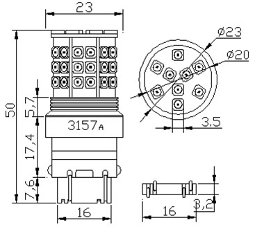

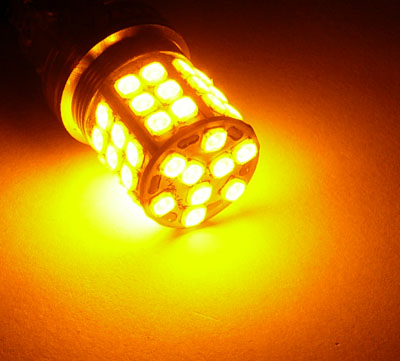

Originally Posted by dmclaren View Post
I've got the stock bulbs out, the 3457 wedge style. Note that this is a 2008 LCI car, but this job would be the same on a non-LCI car except I understand that the bulb base is the conventional style as BMW had used for years though with offset pins.
There are a load of LED lamps that have the same base as the 3457, 16mm by about 3.2mm. It's one thing to plug it in, it's another to fit it through the housing, get a good amount light thrown off the reflector, sufficient overall output and a nice color. I learned that buying a bunch of different bulbs for my E30 project.
The thing showing up a lot these days are the SMD (surface mount) LEDs. They seem to be more compact and pack more LED light sources into the lamp. So I figure I'd go with something that appears to pack a bunch - 45 of them. Will they be any good? Don't know until I try, but I have a hunch these should do nicely.
I took the calipers to the stock 3457 bulb and base, and overall dimensions of this LED lamp look to me to be close:
Dave
Can you confirm please, which type are the LED's used in that bulb:
- 3528 SMD http://img.diytrade.com/cdimg/111169...warm_white.jpg http://www.wayjun.com/images/Led/led-1210.jpg
or
- 5050 SMD http://i01.i.aliimg.com/photo/v0/215...brightness.jpg http://www.effled.com/images/5050%20...ED%20(RGB).jpg
The difference between them: type 3528 has only one chip (2 connection pin), type 5050 contains 3 chips in same capsule (6 connection pin) and the light intensity is 3 times bigger.
Looking to your picture, i assume it's 3528 (smaller size ~ 3x3mm).
or
- 5050 SMD http://i01.i.aliimg.com/photo/v0/215...brightness.jpg http://www.effled.com/images/5050%20TOP%20SMD%20LED%20(RGB).jpg
Since here i can't find, i want to build a pair of these LED bulbs.
Thanks in advance.
They're not 5050, they are regular SMD. I looked on ebay where I bought mine and found some more from the same seller. These are what I bought:
3157 3057 3357 3457 Ceramic SMD 45-LED Light Bulb Amber | eBay
As you can see from my video they look great.
dmclaren is offline   Reply With Quote
