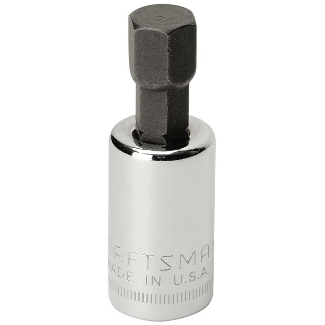

Also: When doing this, I believe it would be VERY useful to get a 5mm hex bit socket that looks like the following:
If I knew about this, I wouldn't have spent 2 hours changing one stupid sensor.
