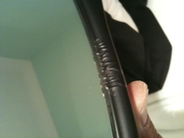

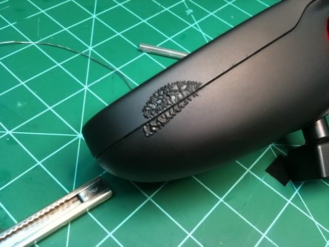

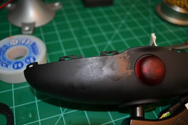

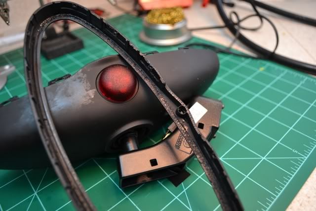

Remove the mirror from your windshield as soon as possible and get it out of the car, it's best to place the mirror face down on a flat surface. Instructions for removing your mirror HERE. If there is any visible signs of the liquid leaking from the mirror clean it off right away and wrap the mirror with an absorbent towel to avoid or limit damage to the case. Many of the mirrors we receive have some visible damage to the case caused the the liquid and in some examples the damage occurred during shipping to our facility as the mirror gets moved around every which way and causes the liquid to spill faster. If there is any sign of the liquid leaking from your mirror prior to shipment you may wrap the seam of the case with a few layers of paper towels and then wrap with tape. Here are some pictures of mirrors that experienced damage to the case during shipment.
