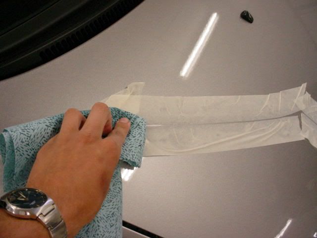

Start off by sanding the entire scratch with orange Scotch Bright, so mask around the scratch first:
Sand thoroughly, as you are about to get some serious polish pressure on the new paint, which will simply be torn out when its not properly attached to the OEM paint. orange SB equals sanding paper wet 2000 , but because of the sponge-like material it travels better inside the scratch, making for a better contact for the paints.
After the sanding, degrease the lot with normal industrial degreaser, NOT thinner as that will weaken the OEM paint you are about to abuse.
