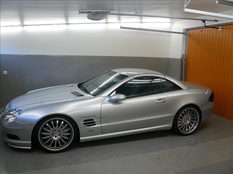

Small OT
i agree with Anri,, about the M113 S/C engine,, it is a real torque beast,,
A friend of mine owns a SL 55 with Carlsson upgrade .. and i have never driven a car that have so much grunt,, IMO it is to much on low revs.. to lunch that car off the line and get a great start ,, is almost impossible..
and not to a surprice.. this SL 55 is by far ,, the best overall car i have driven ,,
drives so well.. great looks and ,, the top down on sunny days,, and all the performance you need,,
and to my big surprice.. when he owned the E60 M5 at the same time,, the S85 used a lot more fuel on daily driving
