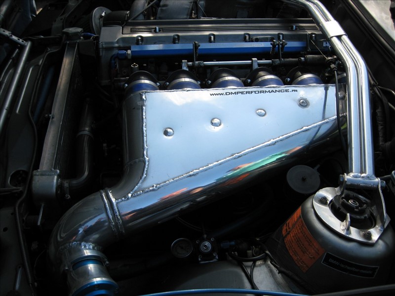

Internal stuff of the 3.6 is very good ,,, strong and quality materials
but you have to lower the C.R.,,,,,, 8.5 is a populair cr that many use,, i would never go more than 1.2 bar,, more boost ,,,more tremendeous heat are made from the engine
another intake box is needed,, new software,, new exhaust manifold,, new fuel system
this is a €€€€€€€€€€€€€€€€€//$$$$$$$$$$$$$$$$$ project
her is a picture from a S38B38 engine ,, in a E30 M3
800 horsepower @ 1.8 bar ,,,,,,, that is a lot,,and the car is easy to drive
