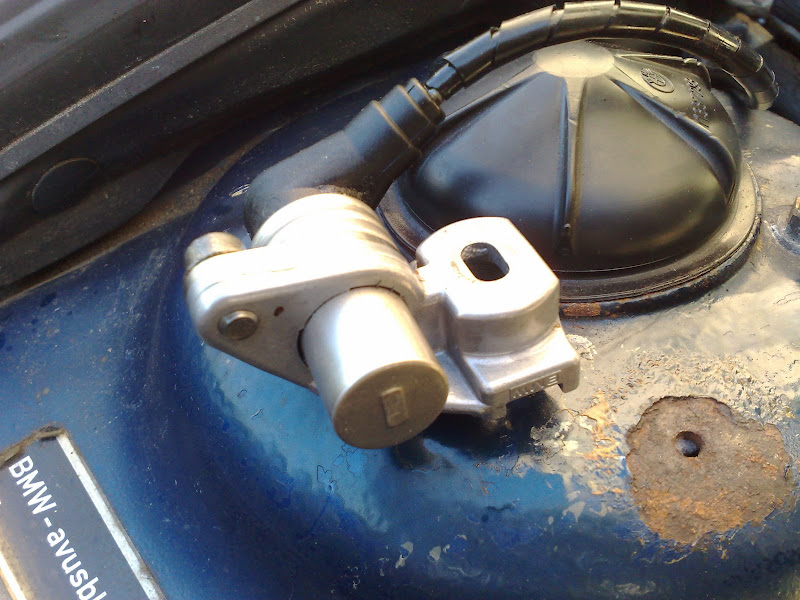

The crank sensor is at the front of the engine, between the fan and the block - I'll upload a picture of it tomorrow as we cleaned mine recently.

Here is the crank sensor installed, with the black cable running off it.
Note that I had removed the viscous fan and the thermostat housing - I'm not sure if you NEED to do that - I wanted to clean everything up anyway, you can see how messy it was!
Here is the crank sensor once it is removed - just clean all the rubbish/oil off it using brake cleaner or WD40.
When you put it back on remember to leave 1mm gap between the sensor and the crank - it works using magnetism (I think).

Thanks for the replys, and Nebpor thanks for the useful pics!
