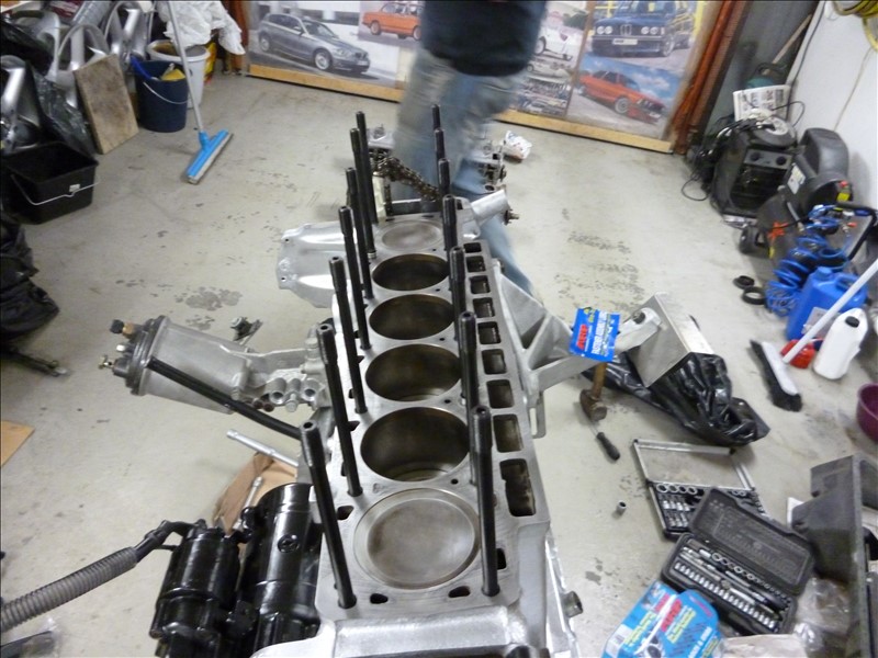

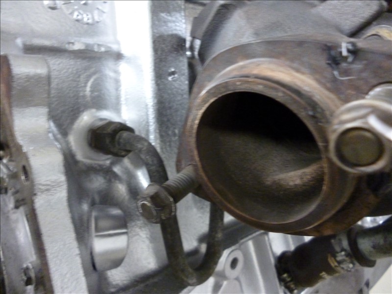

after i took of the valve-cover to have an inpection, i discovered that the camshaft was really worn,, worst on cyl 1, the reason == one of the banjobolts ((2 of them)) got loose ,,so the oilpressure was not optimal,, and the cam got screwed up,,
well i decided to also change ALL bearings in the bottom of the engine ,, so lets start the thread
All parts were cleaned as well as i could,, underneath and inside

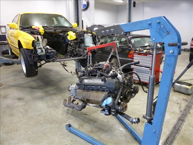

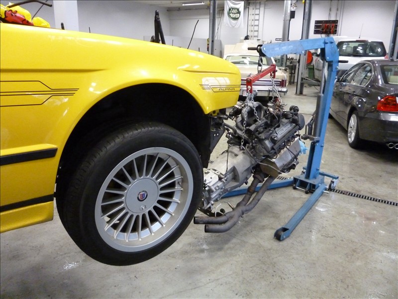

Engine and gearbox came out.....
It came as a result that the crankshaft was worn 5/100 of a mm ,,ALL MAIN BEARINGS,, from 1-7 and also conrod bearing 1-6
so a turn of a 0.25 mm was the conclusion,, that was taken ,,
the backlash of the crank was over 1.0mm and that is not uncommon on a car with heavy clutch.. an Automatic M30 can drive to the moon without a backlash-problem

the cylinder head was shaved 0.10mm
MLS 0.70" /1.778mm headgasket and ARP studs,, IMO the best available on the market,, and a good value for money,,

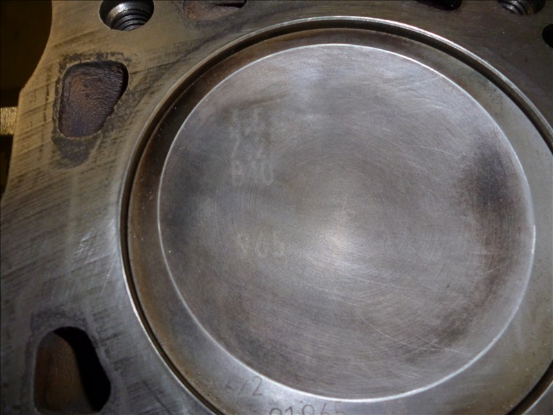

pistons were like new and cylinder walls also,
pistons are oem ALPINA/Mahle..
As you can see
3.5L ,,,,,,,,,,,7.2 cr ,,,,,,,,,,,,, and B10

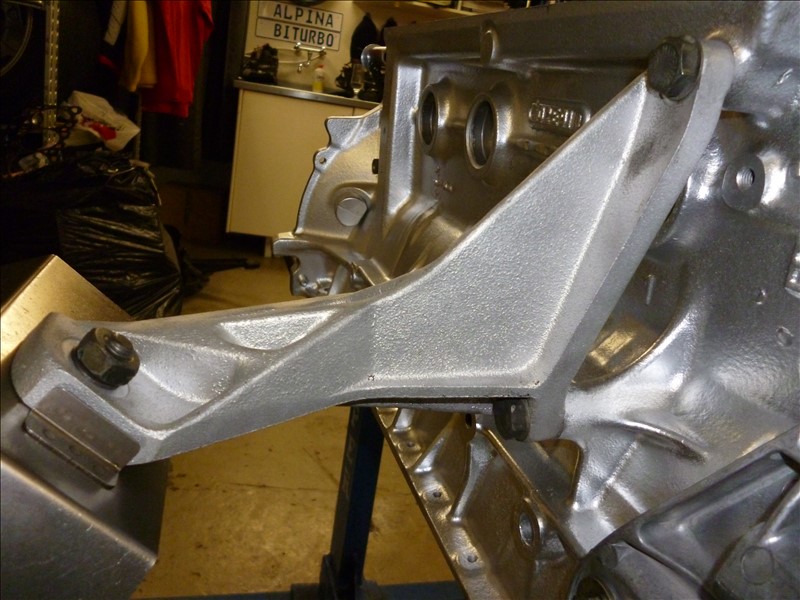

ALPINA engine mounts on the exhaust side,,, NOT oem M30 BMW

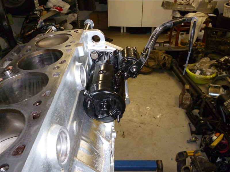

M70 starter (( a lot more powerful vs oem M30 and makes the most gorgeous starting sound ever made))

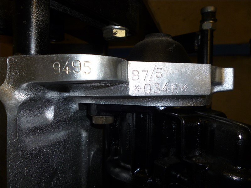

ALPINA B10 BITURBO engine code........... B7/5 and the nr of the car ((0346))
This is not cool ... this is GLACIER cool,, i am a big fan of number matching things

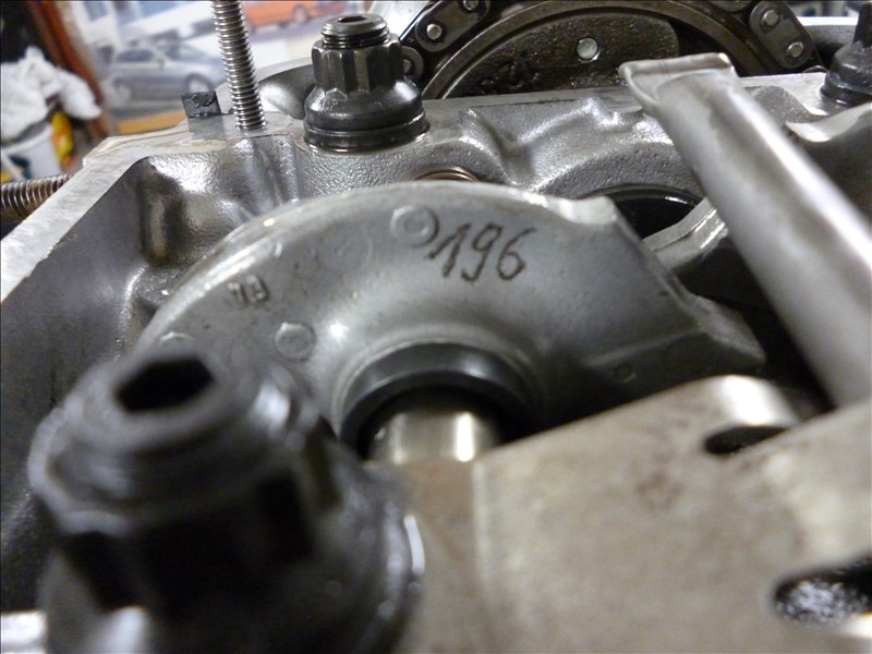

On the B7/5 engine ,, the rocker-arms are strength tested,, and radio-achtivated,, then numbered
,, the result is like this..

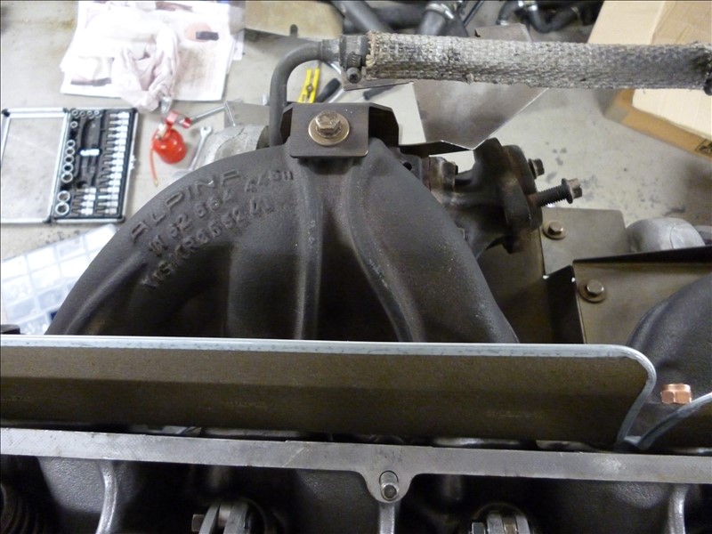

The intake port.......

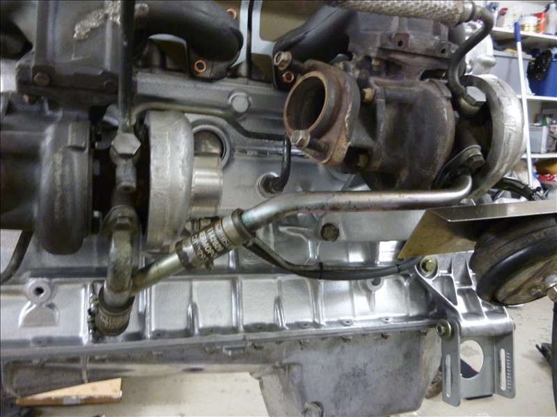

OIL drain,, and coolant drain ((2)) on exhaust side
Exhaust port,,
I think oem ,, because on the other M30B35 the port was very similair

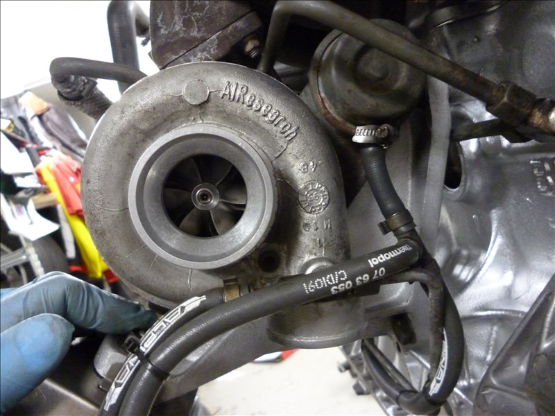

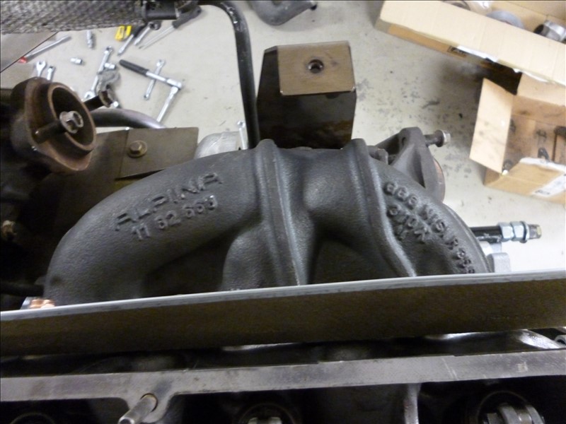

TURBO,,, both turbos were disambled,, cleaned up.. the rear manifold had 2 cracks,, ((not uncommon on a B10 BT)),, my friend who have a VERY big experience with turbos ,, was stunned how the condition was ,, the front turbo had a small backlash,, but bearings and seal was OK,,,,,
((wtf,,,,,,,,, a welding line... yes ))
Here you can see the main reason for special refabrication on engine mounts on the exhaust side
ALL KINDS of shields,,, and a stunning engineering IMO,, and thought all way through

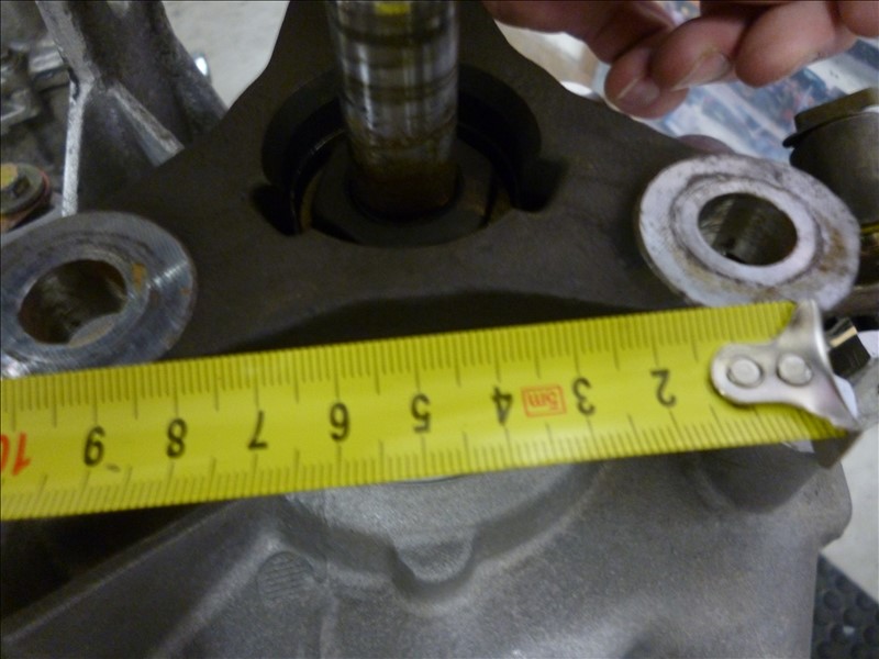

Here we have the G420 6speed ((from a M60 engine,, with 265 mm clutch)) and the G290 ALPINA B10 BT gearbox
The flange is 90 mm between bolts .. on the G420 and is the second large Guibo from BMW/Getrag ,, the G290 and the G560 ((M70 manual)) have 95 mm between bolts

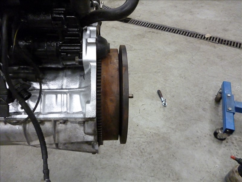

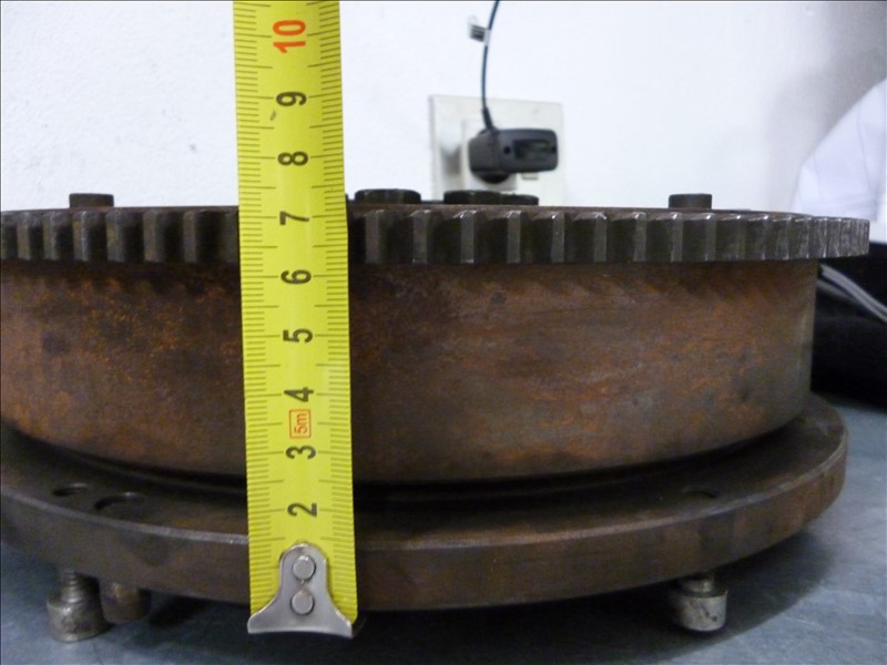

The flywheel.............. ELEPHANT size

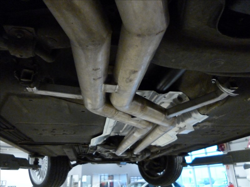

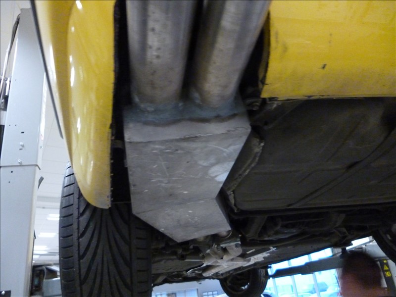

Exhaust..

wow. look at that flywheel! no wonder it has an M70 starter
fantastic quality stuff. looks more handbuilt than on a Ferrari!
Why did you disassemble the front ? I mean, I know its easier ofcourse, but seems a bit drastic? Isn't the front attached the same way as normal E34's?

I bought the M70 starter from my friend that was scrapping a 750,,
and yes as i took the engine + gearbox as bolted together,, it was a lot easier when the front was disambled,, and the work is not that much

Well i was expecting the same sound,, but when firering a 1-12 cyl up you get a total different sound vs 1-6,, but the starter is a LOT faster when spinning the engine around
